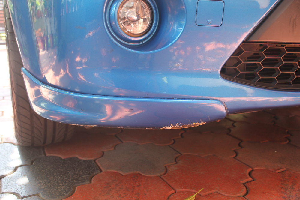

Both the front kits were badly damaged beyond repair, all the inside locks were damaged so was the paint.
Jugad job done right [frustration]
This panel was having a misalignment as you can see from this pic.
The right kit had the most damage, I had once scrapped it pretty bad as well.

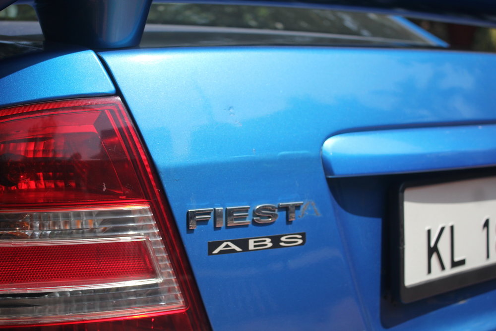

A bike must have rear ended here, and fix up job was pathetic which resulted in a misaligned boot. This was such an eye sore in all of my pictures.
