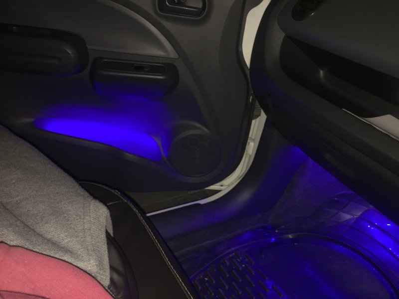

is they are usefull in tacho??
i have done interior lightning few weeks back so some of the wires i have only need to buy relay
today i called in mgp in my area and they told me that tachometer will be delieved in 10 days
interior lights
if you have it then good no issues then proceed with connection thats it. i have done with amber interior to match the dashboard lighting.
