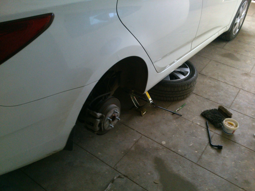

The tools required are just available in your trunk![Cheers [cheers] [cheers]](https://www.theautomotiveindia.com/forums/images/smilies/Cheers.gif)
step 3:
Thats where the Jack needs to be placed
Step 4:
After removing the wheel, keep it it underneath the car as a precaution . Even if the jack fails the car will land on the wheel and not on the ground. (recommended evern during punctures)
Step 5:
Thats how the springs look. The rounded portion shows the root cause of the noise which is the bent axle plate where the spring sits.
Step 6:
Grab yourself a tooth brush and start applying the grease from the axle plate gaps ( where ever there is room for movement) Just like in the pictures.
step 7:
repeat the same to the other side.
Dont expect a service centre to do this kind of a job because service centres only believe in replacing and not repairing (for long term reliability). I've almost covered 100 kms under load after doing the lubrication and there was no noise at all .
My honest opinion is that the spring noise will be eliminated till the grease lasts.
But then it is better to travel without annoying noise isnt it ?
