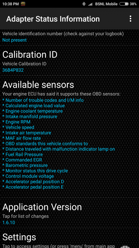

I have purchased the same tool mentioned by you. This is the list of the sensors for my car that the ECU can read / the ELM 327 can read from the ECU. Specially i expected the Exhaust temperature sensor and the CO2 produced.
During routine inspection by MSIL i asked them to scan by their diagnostics tool and it showed the error Code for "Glow Plug" and by this device it haven't showed.
Can you please upload the list of your sensors by your device. Screenshot_2016-09-28-22-38-02-925_org.prowl.torque.png
After Cleaning the MAF sensor it gave me reading about 8.0 to 8.2. Outside Temperature was around 28 Celsius and humidity of 72%. Car was shut off for about 2 hours. whereas your were 5.4 before cleaning and 4.6 after cleaning.

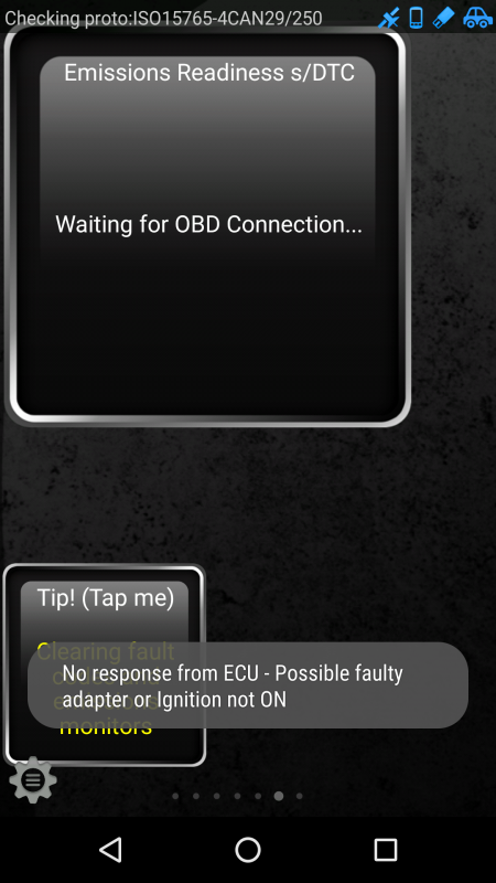

Hi Anurag,
I also bought the same adapter but when I Connect it to the port it connects to the phone but the OBD indicator doesn't glow and Torque on cell phone says "no response from ECU". Check the attached pictures.
So is it a faulty adapter of there is some other settings them I am missing.

Hi Anurag,
Have you connected it to any other car to check? If no, do it and see.
Mostly the OBD-II reader is faulty. Contact the seller instantly asking for refund.

Hi Anurag,
I disconnected the power steering module beneath the dashboard to check whether it will detect the check engine light but as i doubted it didn't show any of the codes. Means it can only read the Real data information but can read/remove any codes from the ECU.
I would appreciate if you could try something to generate a code and try detecting it .
Thank you
