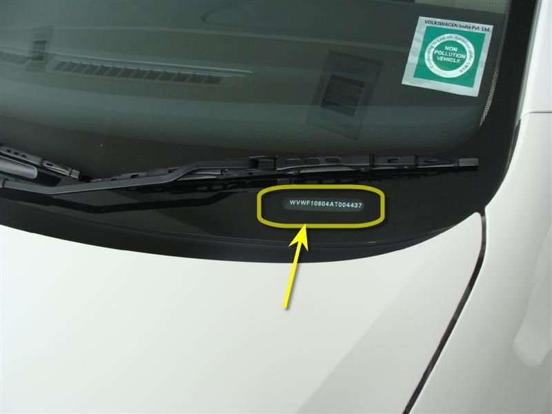

Volkswagen VIN Decoding
Volkswagen (VW) VIN contains 17 Characters and you can find this on the bottom left side of the windshield (Passenger Side)
The 4th Character represents the Month of Production
and
10th Character represents Model Year
If the 10th Character is found as B then the model is 2011.
If you purchase a vehicle in 2010 and found the 10th digit is B It doesn't mean that it produced in year 2011 [confused]. It only shows the MODEL YEAR
Rest of the MONTH Codes are follows
A= JAN
B= FEB
C= MAR
D= APR
E= MAY
F= JUNE
G= JULY
H= AUG
J= SEP
K= OCT
L= NOV
M= DEC
