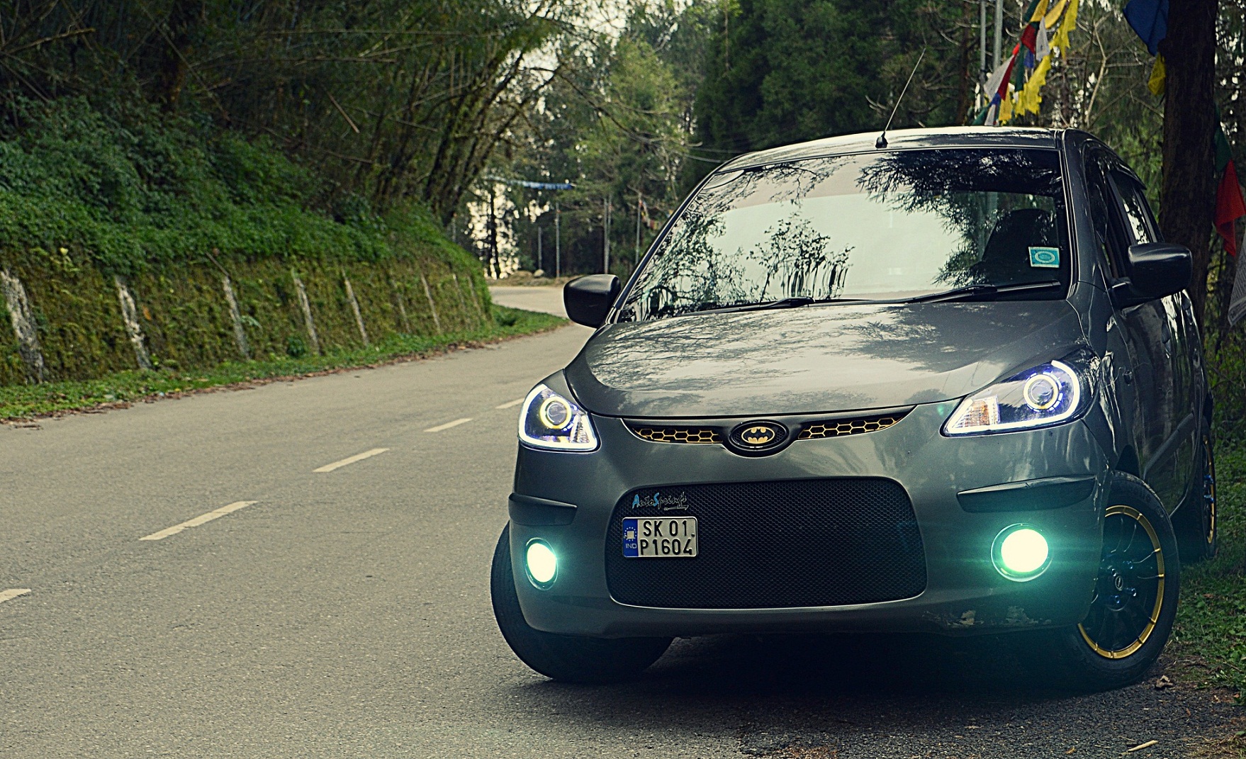

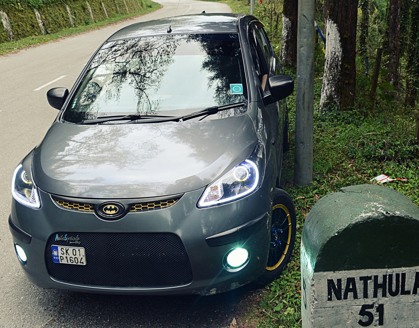

Well hyundai glue is like it easily becomes soft even with less time application of heat although another thing about it is it becomes hard again faster once heat is removed. But opening hyundai headlights are very easy. In my first setup i was running mini 6.0 and current diy is upgrade to rx350 projector with sti-r lens. Mini 7.0 should be a good upgrade with its bolt on application.

Mini h1 is good if you take into consideration the ease of installation its more like plug n play, but again good if you don't wanna use it on dark highway roads as it does not have much distance vision and lots of foreground light. I used gatling gun with mini h1. In case of rx350 installation is real pain and time consuming since it was a diy i used spare set of headlight to work on as i was aware it won't be a day or two job atleast with me. Rx350 requires trimming probably widening the h4 hole of reflector using dremel and then other small holes for mounting projector. But @55w 5000k its real great for driving and much better improvement over mini h1 as my main priority was 50w output and good high beam. As i painted bezel and reflector and since cutting reflector cause cutting of parking light location so had to made provision for parking light which increased the time of retrofit. With rx350 i used e-46 shroud. Although e46 came with centric ring if one wants to install it on 2.5" projector. That is separate thing one can order with shroud . Mini h1 is good projector for city and for moderate and not so dark highway roads you can use a foreground limiter with it to control excess foreground light

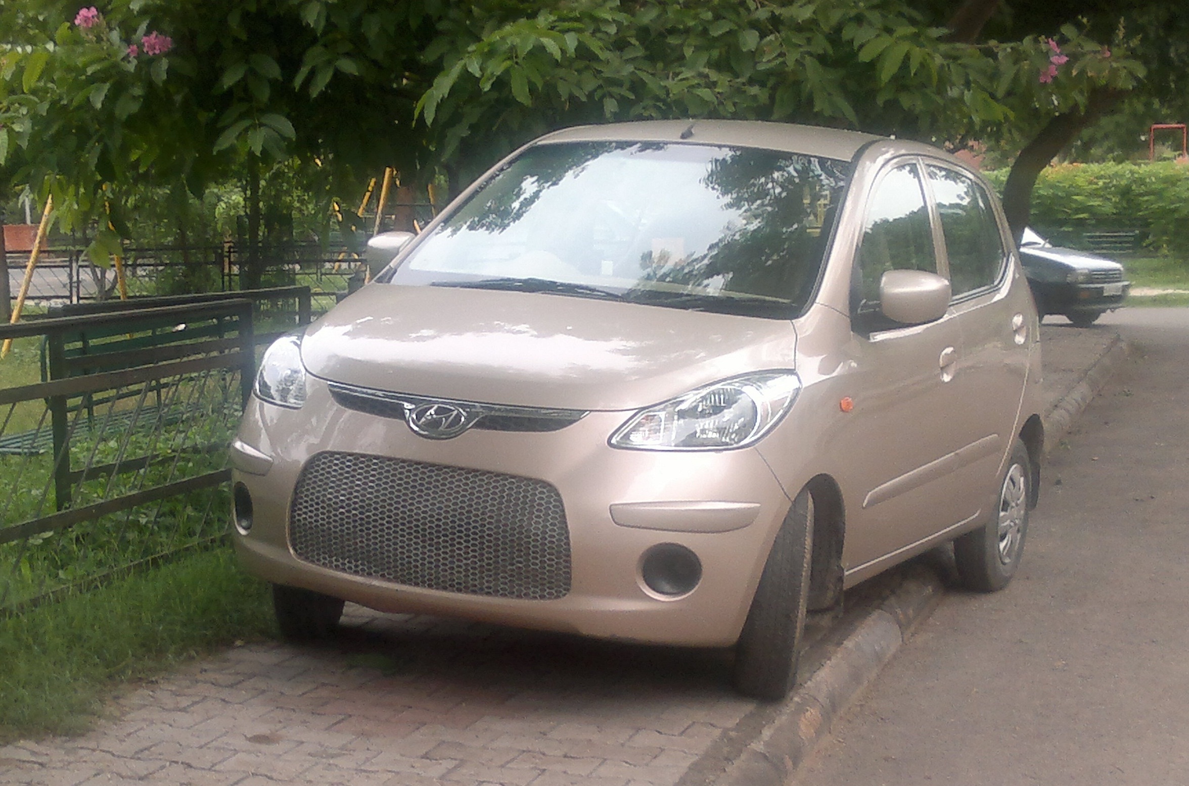

That's an awesome mod. Your front grill looks fantastic. Could you please you help me in getting the honeycomb mesh grill for me.. I am just trying to get one in chennai. I appreciate your help in this regard.
Hi the grill modification looks cool. I am looking for the same grill but i am unable to find it in chennai. Could please let me know where did you find this one and how can i get this one?? I really appreciate your help. Thanks
