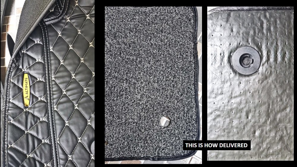

7D FLOOR MATS (Fake “Coozo" brand)
Our aftermarket purchase of 7D Mats has its own story that I like to share here.
On my search, I came to know about them in an ownership review appeared in another forum and were attracted, ordered from that seller as recommended. Unfortunately, I was shocked to see the packing when it delivered by the courier and unhappy - a Delhi local make of different brand name – ALTIMATE ([frustration]) and a disappointing quality. Stitching and outer appearance were okay but reverse side of the top up noodle foot mats are of very poor quality, of cheap rubber. The lock buttons were of poor quality, some are already broken. Somehow managed to set to appear better.
Mistake: I understood that these are fake products, as COOZO has no such mats. I could not return and paid Rs.3700 including shipping. Amazon is full of these mats for all vehicles with a Returnable Option (if you do not like it) for a little more than this price. In addition, we need to be careful to ensure it is not meddling with the foot pedals.
Note: 1. We did not want to do full PVC linings over the original fireproof floor carpet in the car as we have decided to go for an easy to remove aftermarket 5D / 7D mats. The idea is, whenever the vehicle goes for service, we can remove those 3D mats and send the vehicle with smaller foot mats. Otherwise, the cleaning boys carelessly handle them during service; leave grease stains, dry under the scorching sun, and fry them curled…. 2. As I informed earlier here, the dealer provided the carpet foot mats, which we returned, as they are difficult to clean and not moisture /odor proof, and got the transparent one.
