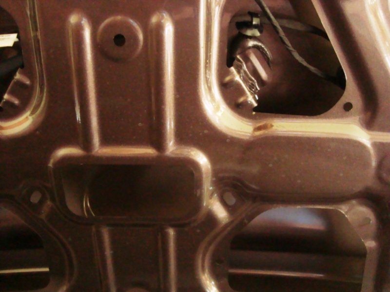

I wanted to ask you all here, the upper side of the boot from the inside, Is there something which looks like white color filling on the root of the boot? when asked the service center folks, they mentioned its the gap filling after the welding is done so that the water does not seep in. That white filling looks so haphazardly done as if like some repair work after a crash done by some lazy workshop guy.
Do you also notice something like this?
I will post the pictures soon about my Car and the Boot roof white filling.

I think, you are talking about the inner side of the boot lid.!
From the screen shot, it doesn't look normal, instead it seems some damages in that area which they covered with some putty or paint.
See here the inner side of my car boot lid:
Infact, the previous models comes with an insulation which is now become an accessory.

that white color thing is not on the boot lid. its inside the roof of the boot. when you put your head inside where you keep the luggage, just roll your head and look at the top? do you see the same filling? its more at the entrance at the top where the luggage sits below

I have checked that also but all looks clean. See SS here:
Hello,
The white filling is present in Tigor's boot to the extreme left and right sides of the underside of the boot as seen in the photo posted. I confirm the same can be seen in my Tigor too. It is indeed an additional rain water seepage protection as if you see from the top i.e. after opening the boot, the rainwater from the rear windshield will directly come on the outer surface of the same location which have welded joints. In order to negate any chance of seepege from these welded points in future this compound has been filled (if by chance of a gap in weld points due to corrosion, which easily sets in costal area for cars having 10 to 15+ years of age). Although personally I think it could have been done in a much better finishing. I have got this confirmed from TASS as well as from a cousin of mine who worked with multiple manufacturers on production line.
