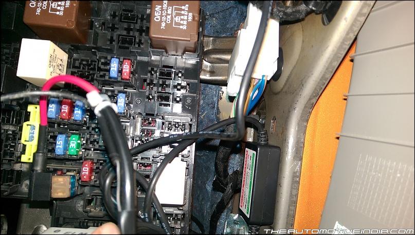

Successfully hard-wired my dash cam on Sunday. Took help from my brother for soldering and routing wire thru A pillar. [:)]
Mini ATM Fuse Tap. The blue pin is cut off and the wire will be soldered to dashcam adapter:
228808d1500460004t-a118c-car-dashcam-review-228431d1499861734t-a118c-car-dashcam-review-img_2017.jpg
Power adapter 12V to 5V. The ring on the +ve wire will be cut off and soldered to fuse tap:
Soldered fuse tap to adapter along with a nut & ring for negative (ground):
Used 5A fuse for dashcam:
Made use of these empty bolt slots for negative line (ground). These are located on the metal bar above fuse box:
Removed 'A' pillar to route wire from fuse box to roof liner. Three plastic locks secures this panel in place. It also houses the tweeter:
The gap was too small to push the adapter's wire from underneath. We had to push another wire from top and pull the adapter's wire:
All set to be tested. Ideally I should have tested before soldering anything, but missed to do that:
Adapter is stuck to a side panel using 3M double sided tape:
This is the on piece of visible wire, that too when IRVM is removed. Note that the L shaped mini USB pin is facing left as opposed to right side which was shown in the product page. A straight pin would have been a safer bet and looked a lot cleaner:
Special thanks to CRACING for his inputs along the way and for sharing his hard-wire installation earlier in this thread.
