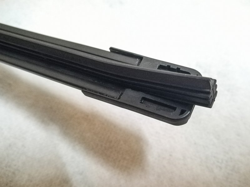

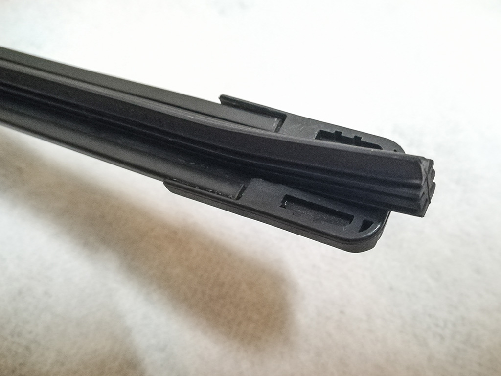

Temporary solution for tilted blade claw on frame-less wiper blade
Did you face tilted blade claw on wiper blade that causes to chattering sound and improper cleaning? Its called Park Set Rubber and it happens when the wiper blade is left idle for long duration or under sunlight or after prolonged usage. To prevent or reduce this problem, we have fold the wiper blade while the car is parked but its annoying to do it everytime. My Bosch Clear Advantage wiper blade ended up with Park Set Rubber. Solution is to buy new blade or the whole set but I have found a temporary solution; that is to flip the blade and it is pretty easy to do.
Instructions:
1. Remove the wiper blade from wiper arm and wash it if its dirty.
2. As shown in below picture, gently pull the rubber blade and you'll see some gap on the end cap. The gap is present on one side only. If you don't see the gap, check the other side. Then carefully pry open the end of rubber blade and gently drag it through the gap.
3. Flip the blade and insert it though the gap. That means you are changing the angle of tilt of blade claw.
4. After it fits on the track, push it back to the end.
5. Do the same thing on the other wiper blade(s).
Note: Above said instructions is for frame-less wiper blades. I think its possible to do same on conventional wiper blades too.
If the blade is torn or damaged, you'll have to replace it. I believe the rubber blade is available in market and should be much cheaper then whole set.
I hope this will be helpful to someone.

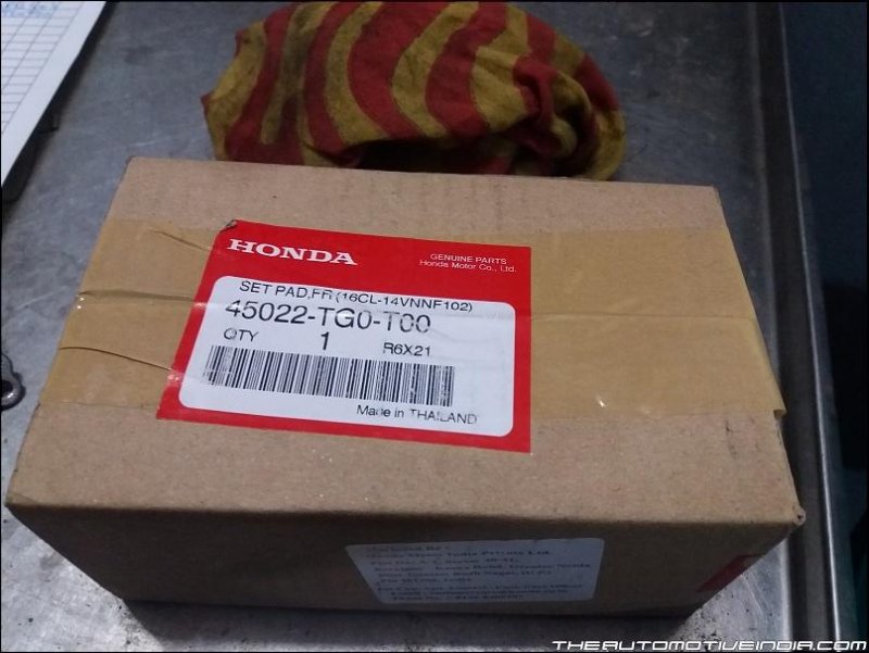

Ya I got the OEM brake pads for the car and they are working fine. Suggest you to consider the OEM ones since its a matter of brakes. Saving a K or 2K doesn't make a sense in important components like the brake pads.

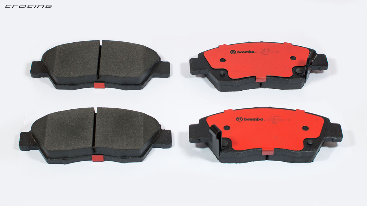

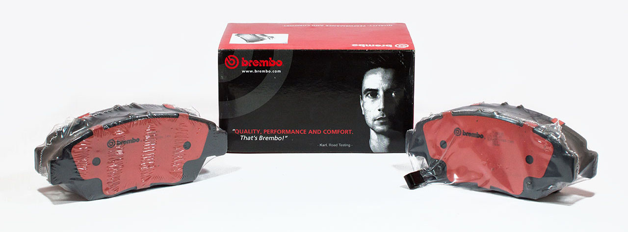

Hello Friends

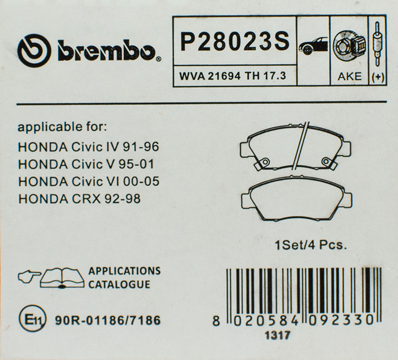

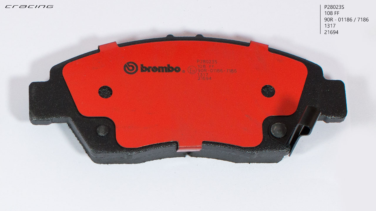

I have finally got what I desired, that is Brembo Brake Pads for my Honda City! I'm a big fan of this brand and always wanted to buy something from them. I have spent several months to research about brake pads and how to install them. Honda OEM Brake Pads cost 5k + Labor and I assumed they don't accept aftermarket parts for installation/replacement. 3rd party service centers like Mahindra First Choice Services use their own parts and workmanship of roadside centers are not good or reliable for this job. So I thought do it myself including engine oil change but friends and Suryaputhra said some complexities are involved and special tools are required to do the job. Later I gave a call to one of Honda ASC service adviser and fortunately he agreed to change the pads that I bring, for Rs. 400 labor. That was the end of my dilemma and I was so glad about it.
Meanwhile I was intouch with Carzspares on facebook, the authorized dealer of Brembo. I bought the brake pads last week for 2.7k + shipping from Amazon India and seller shipped the product promptly. Product was new and sealed with a genuine verification code underneath. Contains set of 4 pads in a wrapped cover and assembly instructions booklet. Additional items like sliding metal clips, grease and etc should be bought separately.

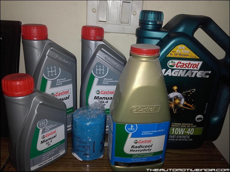

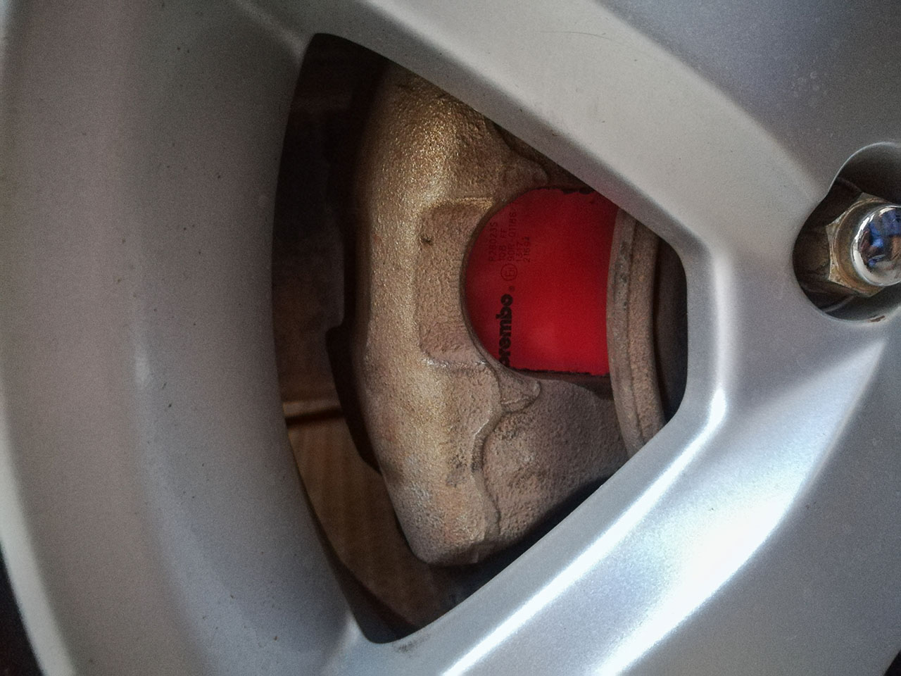

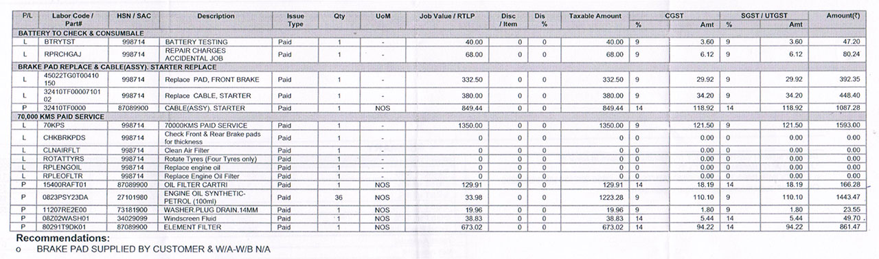

Day before yesterday I took my car for servicing and got the pads changed, as well as Engine oil, Cabin filter and Battery Positive Cable. Total spent is 6.2k, Breakup of parts and labor can be seen in the invoice attached below. Suspensions have gone bad so service adviser has placed order for the same on my request. Its kit of 4 suspensions including springs and costs 16k (Including Tax and Labor). ASC will remind me after getting the parts.
Brembo brake pads are working perfectly, smooth and silent but I think pads need to Bed-In to achieve full performance. Both the rotors are in good shape so no skinning is made. Bed-In procedure is simple; Drive normally for few hundred kilometers and don't apply force apply brakes. Then keep driving normally and enjoy the ride. [:)]
Little about other things; Honda has changed their engine oil from Mineral Oil to Synthetic Oil for almost same cost, that is Rs 1,224 + tax per 3.6ltr. Though I doubt its fully synthetic, must be semi. As of battery positive cable, the existing had collision on terminal champ and it made the connection weak. Now I got the whole cable and distribution board replaced. Cost Rs. 1k + 500 labor.
Thats it for now. Once I get the suspensions replaced, I will post review of the same.

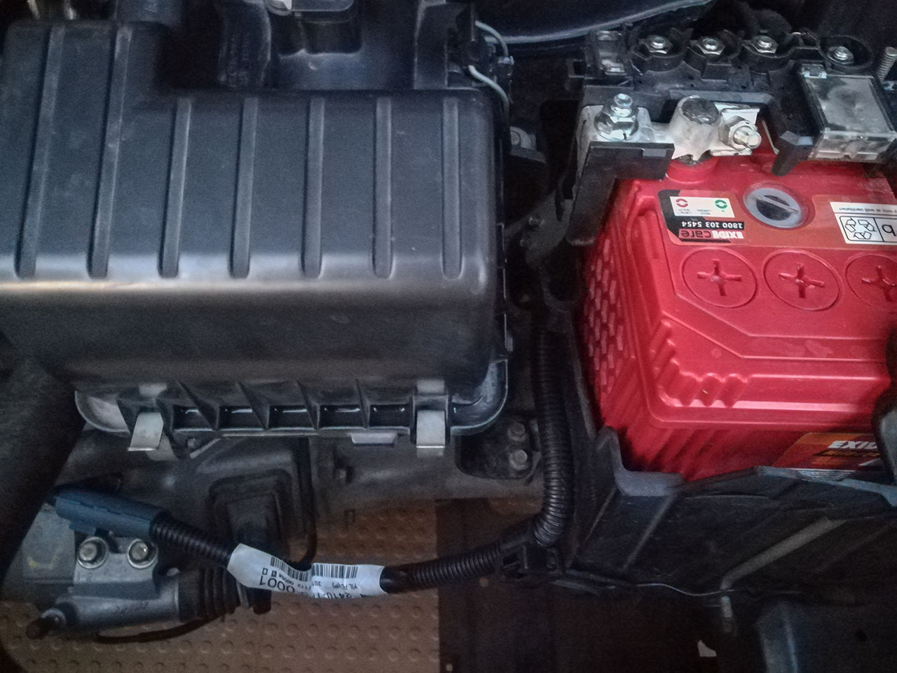

Starter Cable Assembly (32410-TF-000). It also includes distribution board.

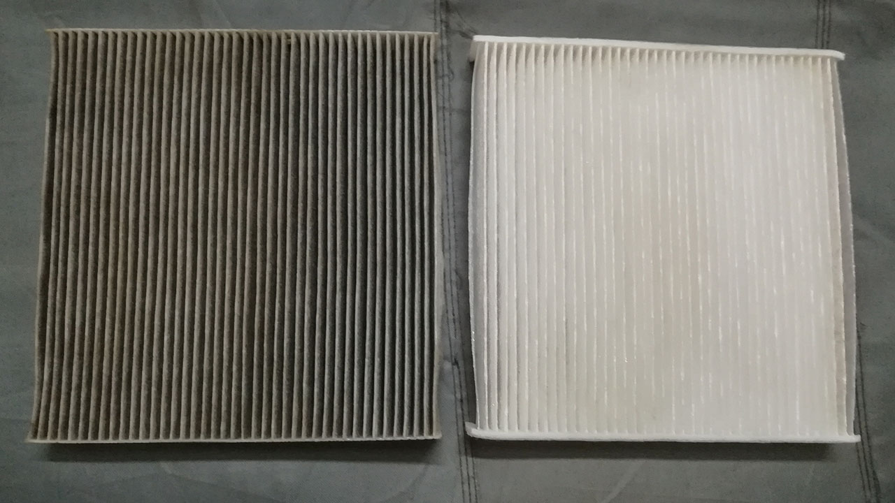

Old dirty cabin filter on the left side and new filter on the right.

Please report back after highway drives about brake feel and performance.
This is a very simple and safe upgrade.
Eagerly waiting for the Brembo updates. I was planning to go for it. Though I'm hearing that there are a lot of fake pads in the market which made me to think twice before going for this. Do share your updates [:)]

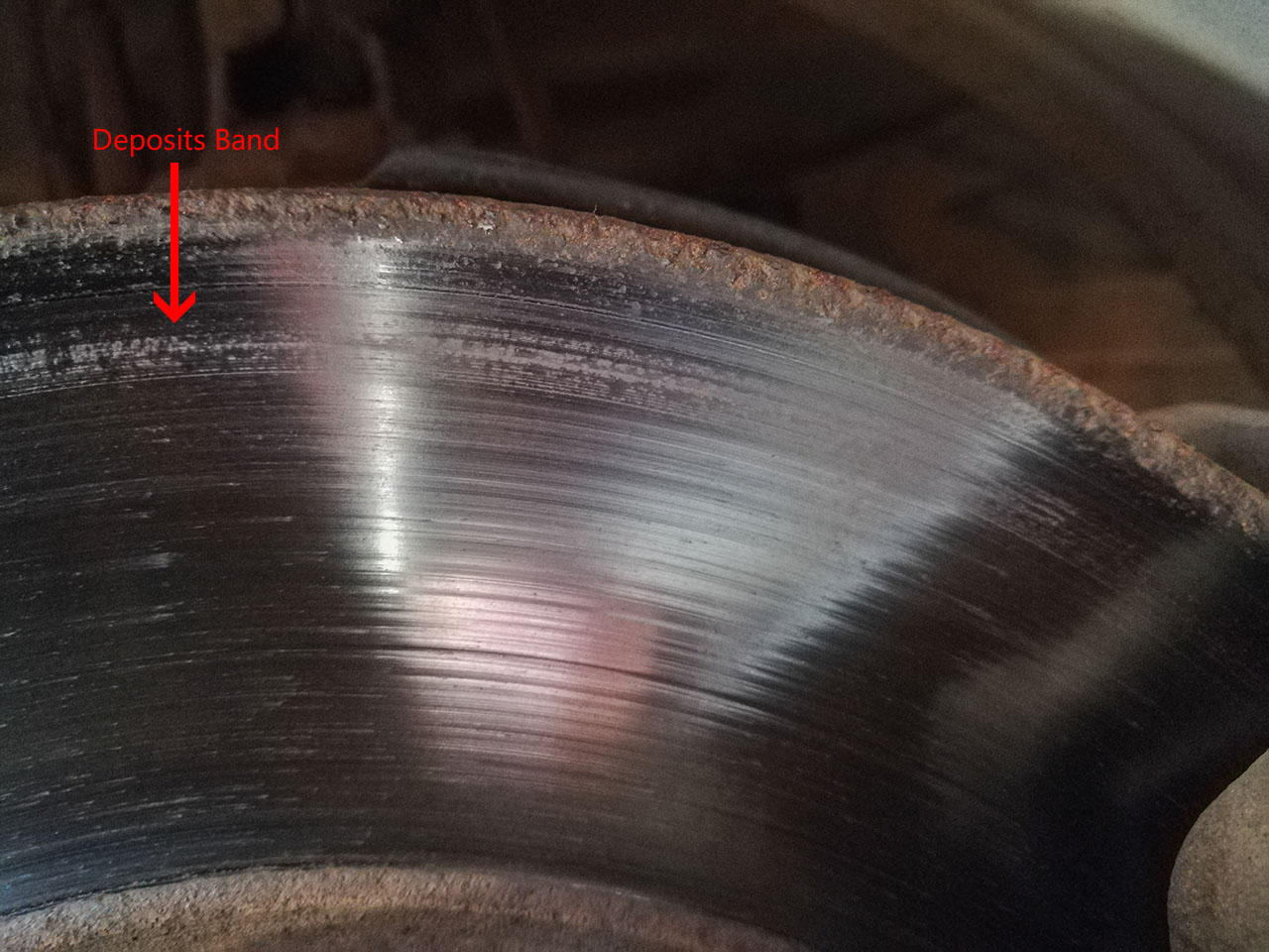

Today I did a short highway drive to perform bed-in and test the brakes. I feel slight improvement (Stopping power and smoothness) in the brakes but it could be subjective also. I was worried about squeaking, vibrations, spongy pedal and fortunately no such issues are noticed. However, one of the rotor has deposits band and I think the pads still need to bed-in properly. Its too early to comment on the performance of pads and I cannot go hard on brakes in the initial period.
As of authenticity of pads; The product box had genuine seal and 16-digit anti-counterfeit code underneath, that needs to be verified in brembo.yesno.com.cn website. At first I wondered why its a Chinese website but later understood that yesno provides anti-counterfeit protection for many major brands in the Asian market. I have also inquired the same with seller and he said Brembo has 4 plants in China and they use Chinese anti-counterfeit website for verification.
I have verified my brake pads on the above said website and it said "Thank you for purchasing a genuine product from Brembo". Next I tried again by entering the same code but then it said "The digit you entered has previously been inquired on XXXXXX and is invalid, be aware of counterfeit products.". Also entered wrong code and found its invalid. That means, the anti-counterfeit code is present in their database, its unique and can be verified only once.
