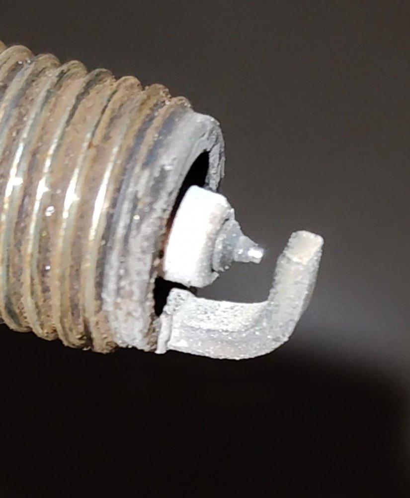

I also inspected the spark plug and it had a white powder on the tip.
A search in google returned that this usually means the engine is running lean. I once raised this concern with race dynamics previously since this started after adding fuelx lite but they were not so responsive about it. Spark plug is under 7000 km old.
Cleaned it with wd 40 and reinstalled.
I think it's to do with the heat range of the spark plug. I had thoughts about this while replacing the stock plug with NGK LKAR8AI-9. But, I know several others running this plug without any issues on their 390. KTM even sells this plug as a power part in other countries. The NGK website also shows this to be compatible with the 390.
I also didn't care much since the heat range number (8) of the NGK was similar to Bosch BOSCH VR6NEU (6).
As per the chart from NGK for cross reference, NGK's 8 is same as Bosch's 4. This is too cold. NGK plug should be 2 points lower.
If you use too cool of a spark plug that doesn't heat up to the proper temperature, it won't be able to burn off the carbon deposits, which can cause premature fouling.
I'm planning to replace the NGK with stock Bosch plug at the next service.

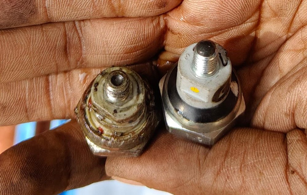

I had to waddle my way through a traffic congestion for about 15 minutes in 1st gear. This caused the infamous 'Low Oil Pressure' error in speedo. I was pretty sure that this is nothing to do with the oil pressure as the level was correct and these pressure sensors never really work unless you are extremely low on oil and the oil pump is running dry. For old bikes like the Yamaha FZ, they used to provide a nut on engine head which we can unscrew to see if oil would gush out. This was the only way to check the oil pressure. [shock]
This sensor was last changed about 5 years ago and for a Rs.150 part, it held up really well for so long. I procured the replacement part from a nearby Bajaj service center as it's a shared part in almost all Bajaj bikes like the Dominar and 200 NS.
Part: DK101225, Rs. 148.
This is a normally closed sensor, meaning that electric continuity is closed when the engine is off. When the engine is running, oil will go inside the sensor and push on a spring mechanism, thereby disconnecting the continuity. So, as long as there is enough oil pressure to keep the spring pushed in, the ECU knows that there is sufficient oil pressure. But, over a long period tof time, heat cycles and dirt from the oil can hinder the spring mechanism from working correctly.
As you can see from the photos below, my old sensor had been through a lot of heat cycles and the black moulding which connects the two parts of the sensor had completely disintegrated. When I tried to remove the wire to this sensor, the outer part of the sensor was rotating freely since it was no longer connected to the thread part which bolts on the the engine.
About the actual job itself, it's pretty easy as long as you remove the tank. It can be done without removing the tank as well.
A box spanner is essential to get this done.
I took the bike for a short spin after the work and the error never came back. So, it was a successful DIY.
