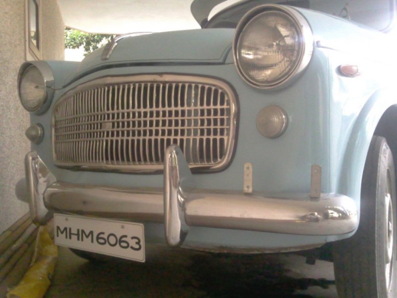

Hi All,
After restoration of Fiat 1100 select 1960 make reg.no.MHM 6063, I managed to get this lucky no Fiat 1100 select 1962 make. R.T.O. registration no MHP 786.

Here are pictures of MHM 6063 Powder blue and white top.
And pics of MHP786 Verde color

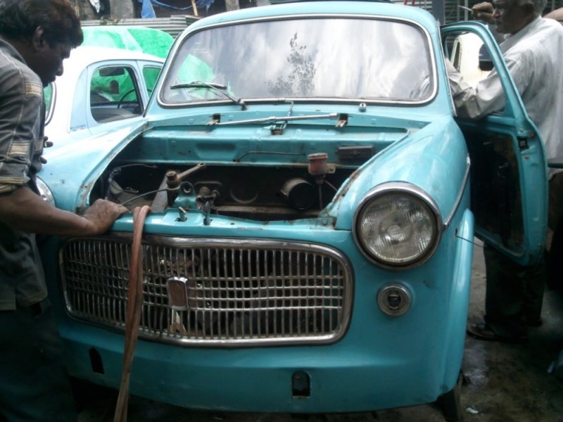

Work of car started, here are pictures.
There in no cross member chasis, just a small patti is welded, and from bottom chasis is totally rusted.
Flooring of car is also totally rusted.
