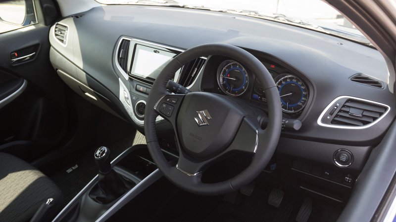

Congrats on the RS, Red looks really sporty and so does the black grill which goes hand in hand with wheels .
Can you share some pic of interiors also what was the on road price for RS ?

Thank you [:)] Car was 10L on road.

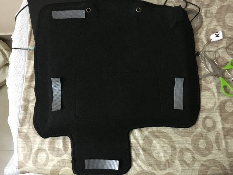

Did a simple DIY for the moving driver side mat. As I reported earlier, I have bought MGA floor mats and the issue was, it moves slowly and the clutch pedal gets stuck under the mat at times, after about 200 kms of drive.
Bought Velcro from Amazon along with 3M Bonding Tape and stuck the Velcro underneath the driver side mat. Did a test as well and it holds the mat firmly to the ground. No mat movements again. I really wonder why the mat hook was not provided at all.
Too bad that MSIL for not including hooks/locks on their foot mats. I stuck a 10 cm long velcro strip (the hard one) under my noodle mats which are doing good for a couple months now. Didn't think of 3M tape back then and used a super glue (like Anabond).
Can you please share the links for your velcro and 3M tape?

Mat hooks are there under the driver seat, below the floor carpet. Unlike in the image, the two hooks you see under the lever are not visible, you'll have to cut two holes in the floor carpet to expose those hooks. At least that is how I did it in my Zeta 1.2. Press on the carpet near the area shown in the image and you'll be able to feel them.

Oh thats news to me. I did not find any sort of hooks anywhere under my seat or that areas . I dont understand why Maruti needs to hide such an important thing. I also asked the service/showroom guys as well and they too were clueless. Cut the OE Carpet ? Thats frustrating for me [frustration] Anyway thank you for the details [:)]

Read the owner's manual, there may be a lot more other things that will be news to you. [;)]
I asked the same thing at the service center because the mat would keep sliding towards the clutch lever causing an obstruction but they cluelessly told me that's how it is and nothing wrong with it. This was before I read the manual.
It is just two slits really, nothing damaging to the carpet. I did it with an old scalpel.

Here you go
https://www.amazon.in/gp/product/B0156EYYOM/ref=oh_aui_detailpage_o00_s00?ie=UTF8&psc=1
https://www.amazon.in/gp/product/B001O6T2ZS/ref=oh_aui_detailpage_o01_s00?ie=UTF8&psc=1
I read everything actually, might have missed this or dont remember as I bought the mat one month after buying the car. More attention went to service/maintenance side, and its a huge manual as well [:D]
