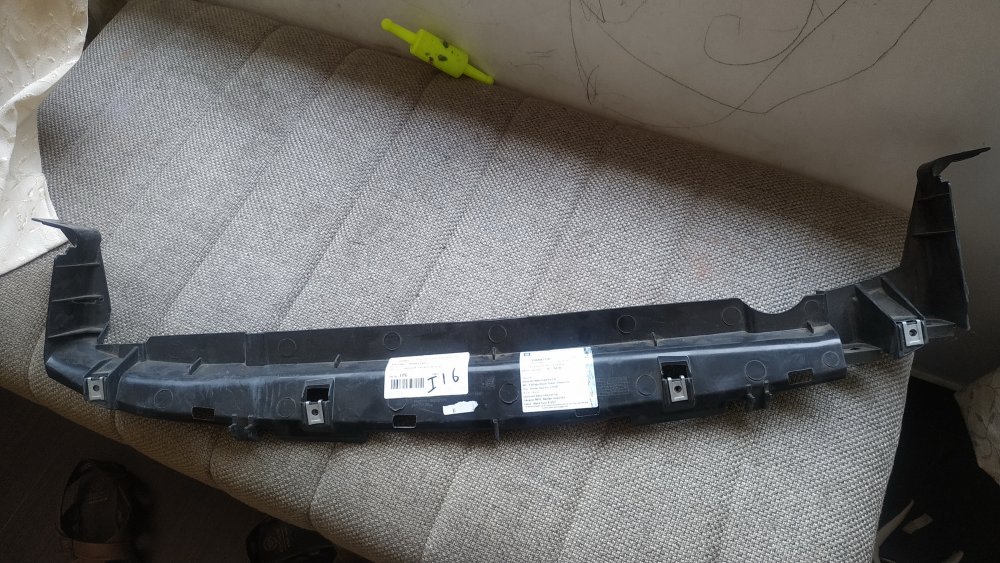

Remove the intercooler cover.
Three clips, two of the snaps on the fascia cover itself.
New vs. old broken one.

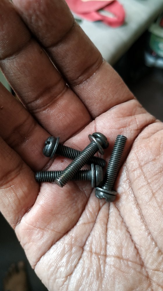

Screw type spring nuts that holds the bumper and sump cover as well.
Replaced them with M5 (8 mm head) bolt type.
Snapped in well. ₹ 5.00per piece.

Bought M5 bolts. ₹ 6.00/each (came as set with nut and washers). Didn't have enough length to reach the nut spring.
Got longer bolts. These came for air filter covers of most bikes. ₹ 6.00/each.
Added a washer and secured everything.
