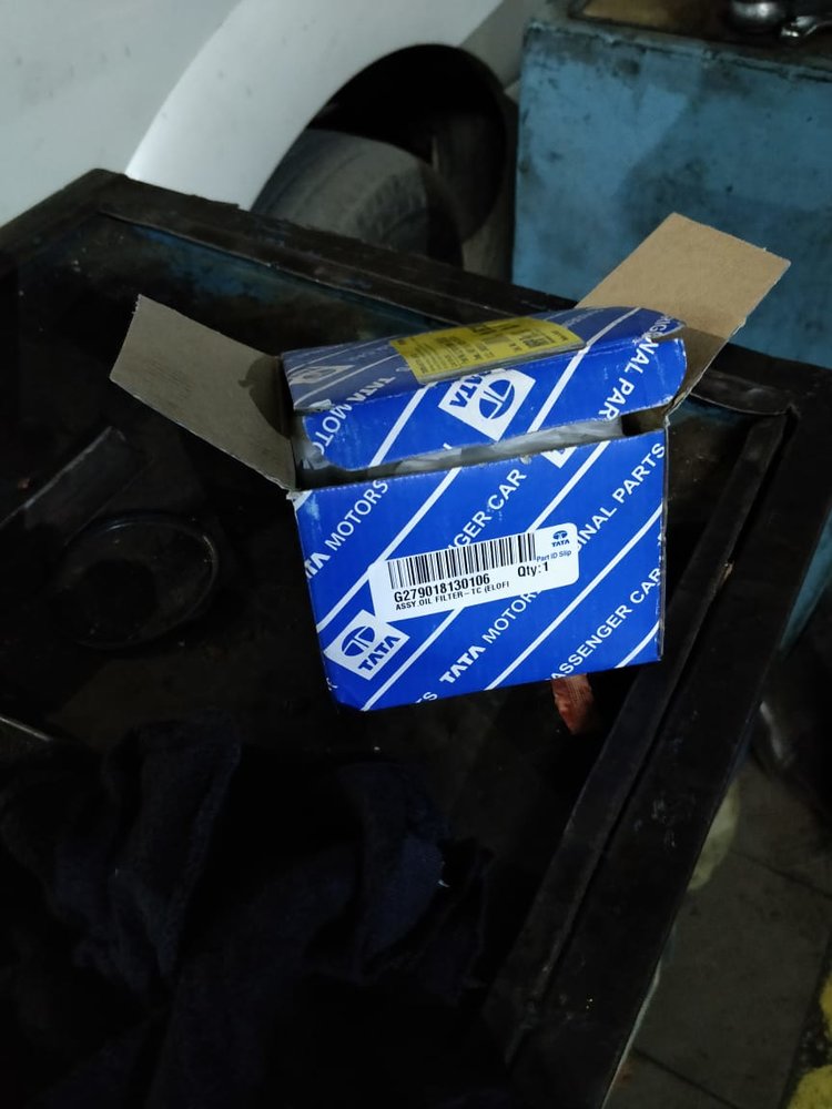

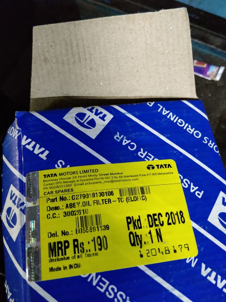

Engine oil and oil filter was changed again. Actually It was being changed at every service. I know it's finicky. But that is to allay my tensions.

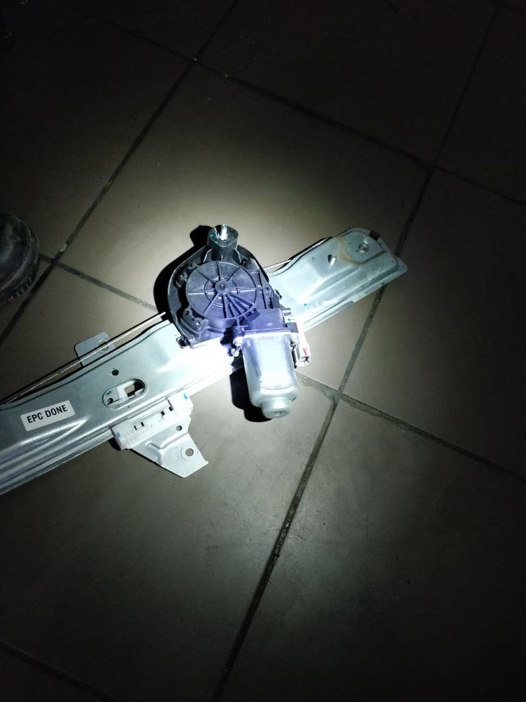

Drivers door glass wasn't winding up and down freely. The whole assembly was opened and changed under warranty.

oil filter for nexon
the sump draining old oil.Sump is very straightforward in nexon.Very easily within reach.Drain bolt is also front facing and easy to open and accessible.
the driver door pad is dismantled to take out the defective part
this is the winding motor .Its alright.But the base part/channel for winding is changed.
