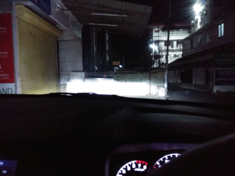

Its been 4 months since i switched to LED headlights. After numerous long highway trips at expressways and country roads, i'm impressed with the capabilities of LED headlights so much so that i can't even think about switching back to halogens.The high beams are really effective even at highway speeds of 100 + kmph. I wasn't very happy with the LED fog lights upgrade but it has grown on me and i turn the fog lights on every time i hit the highway. Fog lights are very effective in spotting the potholes and speed breakers. Thanks to the LED headlights, i prefer most of my outstation highway trips at night these days. It helps me save time and also reduces the mental stress of dealing with the rogue traffic in the day hours. The chinese LED's have been reliable too since i must have used them for at least 4000 kms in last 4 months and they have held up well so far. Here are some of the recent pics. pics are in the order No lights, FOG lights, Fog lights+ low beam, fog lights+ high beam.

thanks for the update sumesh. the beam.pattern is really good.
even on my i10 the cree led are working well long term. although the led technology wasn't as bright back then, they're quite adequate and Reliable too..just did 500km yesterday and these leds worked beautifully.
