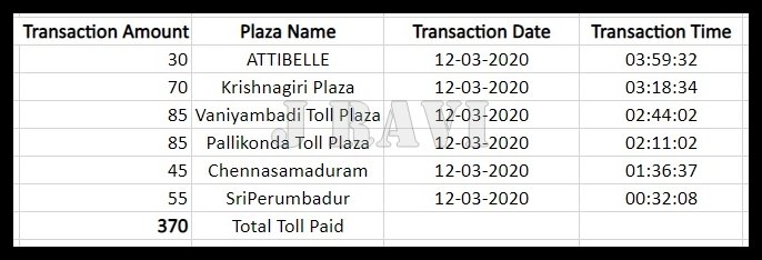

Did another non-stop night driving after a long time. Left Bangalore Basaveswara Nagar home at 11:05 pm yesterday and arrived Chennai Royapettah home at 4:08 am today. Blue Di's FASTag had problem-free pass-throughs. All the toll plazas were free of congestion. I really enjoyed the drive after very long time.

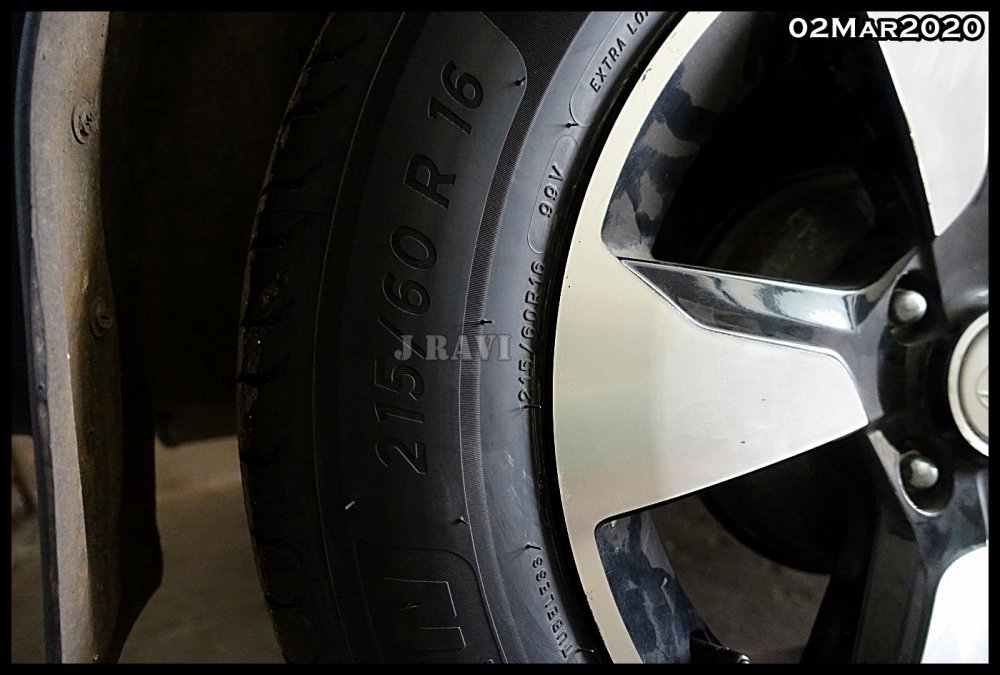

Got frustrated today morning itself when I saw a flat rear left tyre of Blue Diamond. That was the fifth puncture on the fourth tyre in 28,375 km within two years. Only one tyre - the front right, previously and presently the stepney - remained free from punctures. The first four punctures were due to my Sach Pass and Ladakh drive. We were to go to a function in our car. I cancelled the car and rode to the venue in my Thunderbird 500 instead. After returning from the function, I decided to replace the four tyres with Michelin as I don't want to drive with 4 punctured and repaired tyres; so rode to Lal Enterprises near my Chennai home and got a quote for 4 new Michelin Primacy 4 ST tyres for Blue Di. Mr Navratan, the owner, quoted ₹ 8,800 each for 4 inclusive of GST plus alignment and wheel balancing. When I explained the present status of Blue Di, he sent 3 people in his auto rickshaw with tools. They changed the flat wheel with the stepney and took the car to their showroom. Later, I walked there, paid for the tyres and services [₹ 36,970 totally] and drove the car back home. Apart from the tyres, valves were replaced too. The OE Good Year Excellence tyres were the worst, when it comes to puncture-resistance. Never did I replace my car's tyres within 30 k km. Anyway, now I feel mentally relieved.

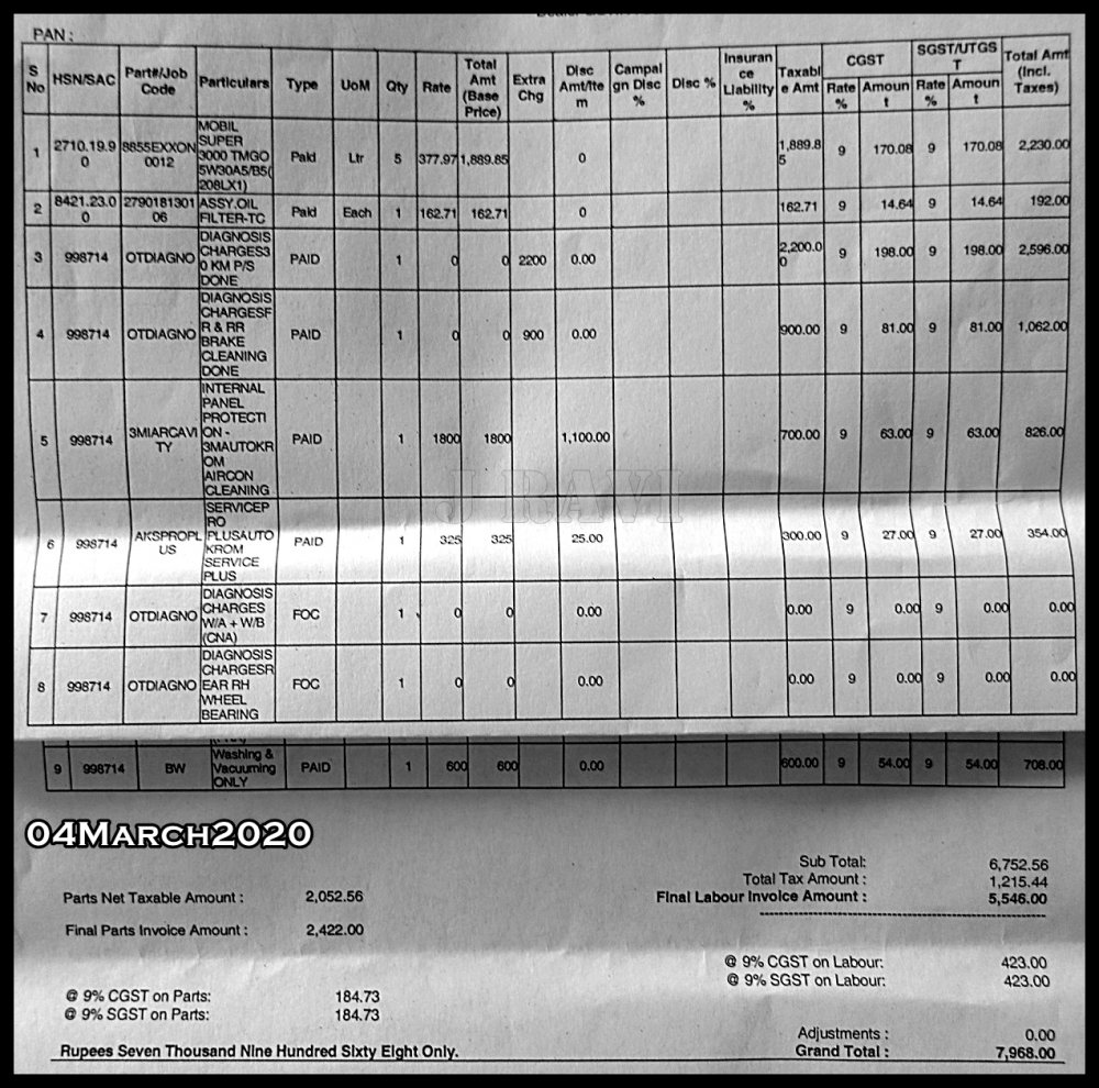

Fifth [Paid] Service @ TAFE Access, Greams Road, Chennai . 28,379 km . ₹ 7,968
Since Blue Diamond drove for 15 k km after the last oil change, I took her to TAFE Access, Greams Road, Chennai for the fifth [paid] service. Left the car at 9:30 am yesterday [04/03/2020] and collected it at 6 pm. The bill amount was ₹ 7,968. I was told that the rear right wheel bearing - which was making some sound - will be changed under warranty after getting the part from Tata Motors, Pune by next week.

Did Chennai>Bangalore non-stop night drive yesterday and today. Left Chennai Royapettah at 11:30 pm last night and reached Bangalore Basaveswara Nagar at 4:45 am today. Home-to-home drive took 5 hours and 15 minutes. Enjoyed the driving - both psychologically and literally - on the new Michelin Primacy 4 ST tyres and post oil replacement service. I felt the car more planted in high speeds with the new tyres compared to the old OE Good Year. Braking was also more precise. Ride quality was also far superior than the old ones. Passing through the toll plazas was very easy and quick.

After my yesterday's Chennai>Bangalore drive, I noticed a strange behaviour by Blue Diamond. For the first time, Blue Di showed the distance between my Chennai and Bangalore homes as 354.8 km on the trip-meter. Earlier, it used to show the distances above 361 km. Here, I have compared the past drives, Chennai>Bangalore only via the same route and not vice versa. NaviMaps also shows 354 km and Google Maps, 356 km for the same origin and destination via the same route that I take. Now, Blue Di's trip-meter matches with NaviMaps, Google Maps and my previous XUV 500 within 2 km range. One reason for this change that comes to my mind immediately is the tyre change. Perhaps, the new Michelin Primacy 4 ST tyres are slightly larger than their predecessor, Good Year Excellence, although the specification is the same 215/60 R16. Even a few mm extra could account for this change in the distance due to less revolution of the wheel. There was no software updating done during the recent fifth [paid] service. I will be keenly watching the trip-meter readings from now to confirm my hunch.
