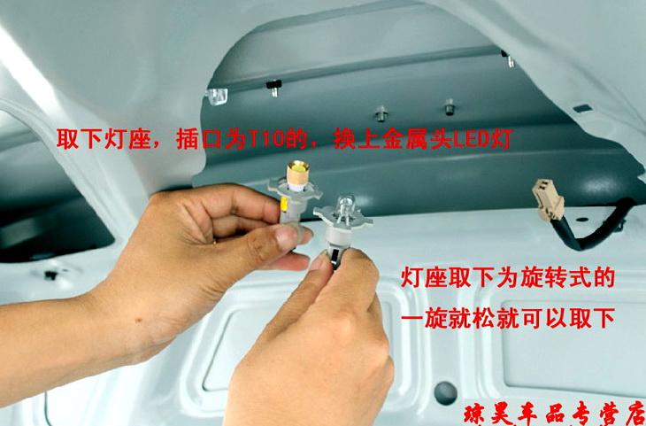

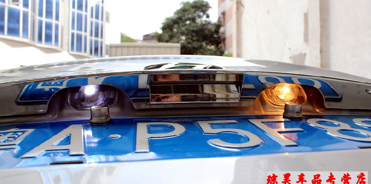

SOMETHING ABOUT HYUNDAI VERNA NUMBER PLATE BULB
Dr MUDHAN , I have read your thread many times , have suggested your thread to many members but I don't like to visit here…. Reason: after reading I so want to order all those things you ordered online [clap] [:D] this thread is just awesome. …..I was thinking of changing the reverse lights for my Verna…….
Your first line gave me a shock and then it was a pleasant shock to me as you wanted. [lol]
Thanks for everything.
Coming to your queries:
You mentioned that you wanted to change reverse light but the link indicates number plate lamp. I hope you meant only number plate bulbs for you.
As you know the bulbs are universal. But any specific assembly / socket should be custom made to replace as plug and play. In this case, I understand, you want to replace stock bulb to led one. I assume OE Verna bulb comes here with fixed adopter and as such the bulb can’t be separated. If this is correct go far this as it is nicely custom made, no warranty issue too.
Retailers from aliexpress buy from one manufacture and price the product according to the profit margin they want, and the price also depends upon the color you choose, shipping, single/pair or multiple numbers.
I find this seller is the cheapest as on date as the price for 1pair is US $6.99 (Approximately Rs. 439.05) for white color with free shipping to India.
Hyundai Solaris Verna license plate lamp 5 5050 license plate lamp T10 Hyundai Solaris Verna adapted for a pair-in License Plate Lights from Automobiles & Motorcycles on Aliexpress.com
I don’t find the product in ebay.com, as always I counter check, would be cheaper sometimes!
Check, if the bulb can be removed from your original socket, buy only the bulb which is still cheaper and you can get from any auto accessory shop or ebay.in.
Regarding interior lights for your car, tell me what your exact requirement is. With the bulb specification and knowing the available space we can get the best match.
We need not worry about 'error free/load resistor bulbs' and I don’t think so it would be an issue for Verna (ANHC has no problem). This is an issue with luxury cars, may be more with imported ones.

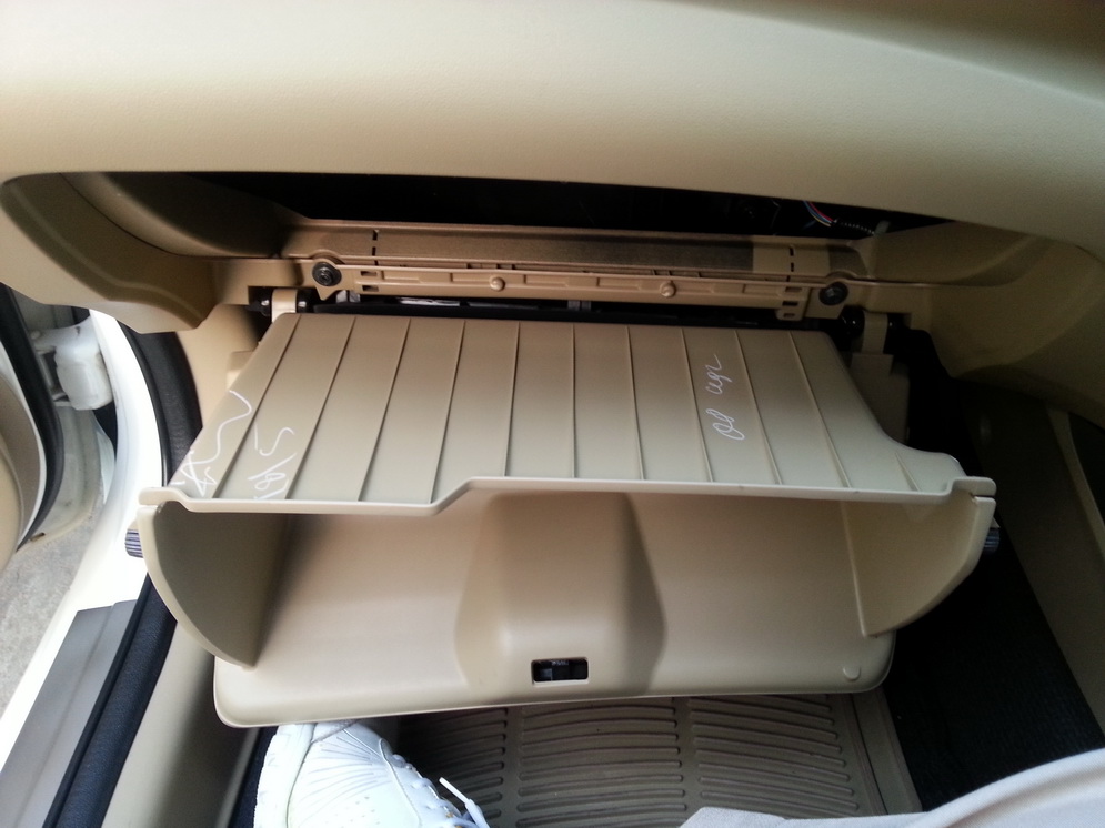

GUIDELINES FOR ANHC CABIN AIR FILTER CLEANING
Cabin air filter is used to filter out dust and debris from coming into the passenger compartment to keep the air healthy & several factors determine how often the filter needs to be replaced, such as driving conditions, dusty roads.
PROCEDURE ADOPTED.
SUMMARY:
Open Glove Box- Remove all the contents -Push In Side Walls- Lower Glove Box To Floor- Note Blower Motor Housing- Push Filter Cover Clips In- Slide Out Cabin Filter Tray- Note White Papery Cabin Air Filter In Tray- Remove Element From Tray- Remember Air Flow Direction Indicator- Vacuum Air Cleaning- Replace Filter Element In Tray - Slide In Cabin Filter Tray- Snap Side Clips Into Place- Glove Box Rubber Stops Pushed In- Test Glove Box Operation- Close Glove Box.
Be sure to make a mental note of how the element was orientated in the tray with the "Air Flow" arrows pointing downwards.
If your current cabin air filter is in good condition we can just tap out the large debris or bugs and remove any dust or pollen by a vacuum cleaner(soft & slowly) before re-installing it.
If the old cabin air filter is dark grey or black with pleats clogged by dust, dirt, hair, and other debris, we should replace it with a brand new filter through the dealer.
I understand that HONDA uses the same for all models of HONDA CITY since 2006 and if anybody can find out the part number and whether available after market with reputed automobile shop like Popular Motors it will save us a lot.

Thank you for taking your time to guide us on how to clean cabin air filter our selfs. It will be very helpful. I didn't even know there is a filter inside dashboard. :p
Anyhow, I just removed mine and its clean as yours so replacement isn't necessary. There was some dust above and I cleaned it with a paint brush but can we wash the filter with water as well and then dry it? or it damages the filter?
