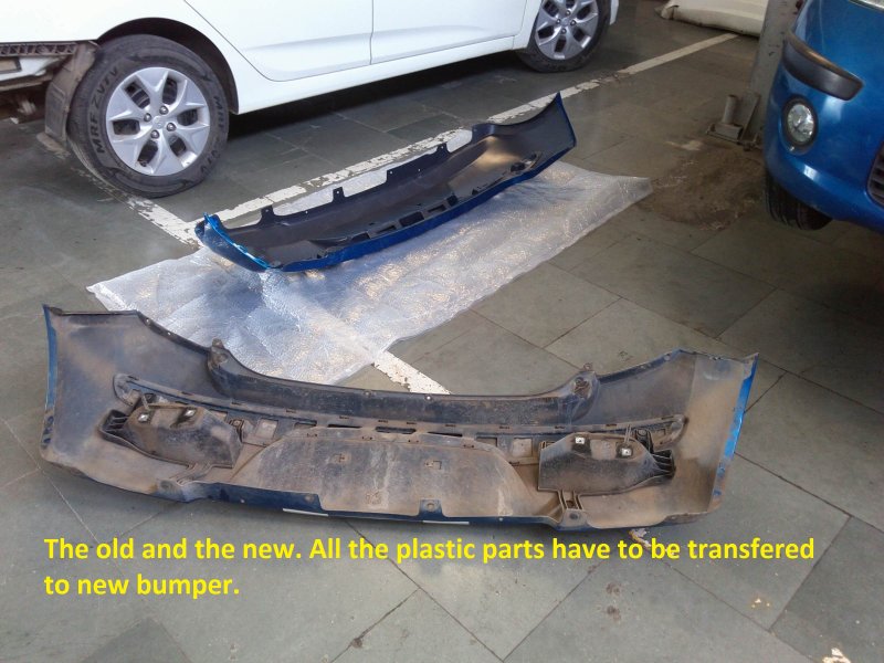

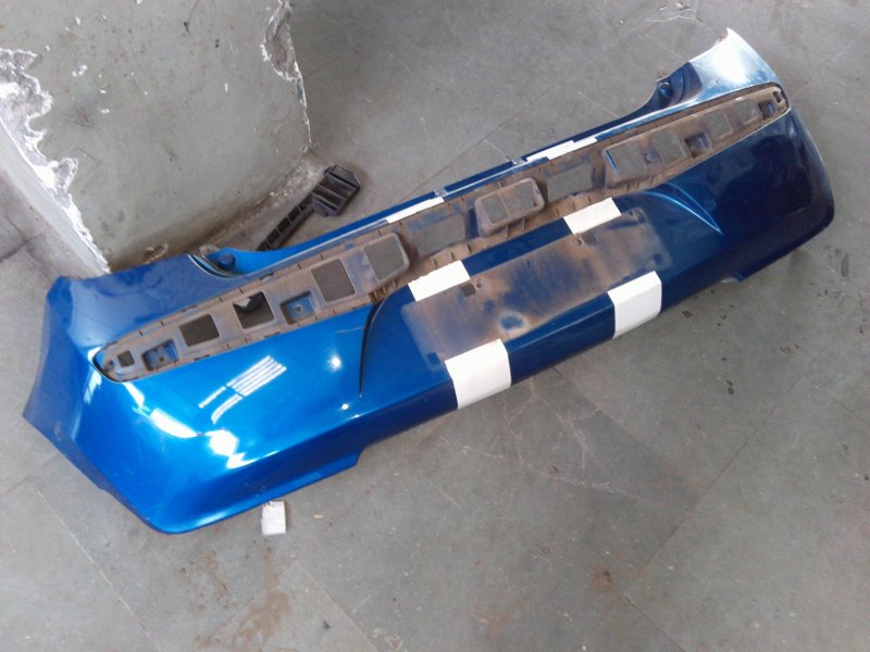

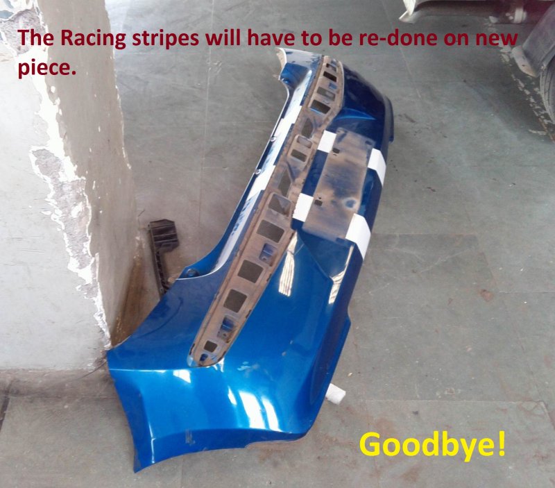

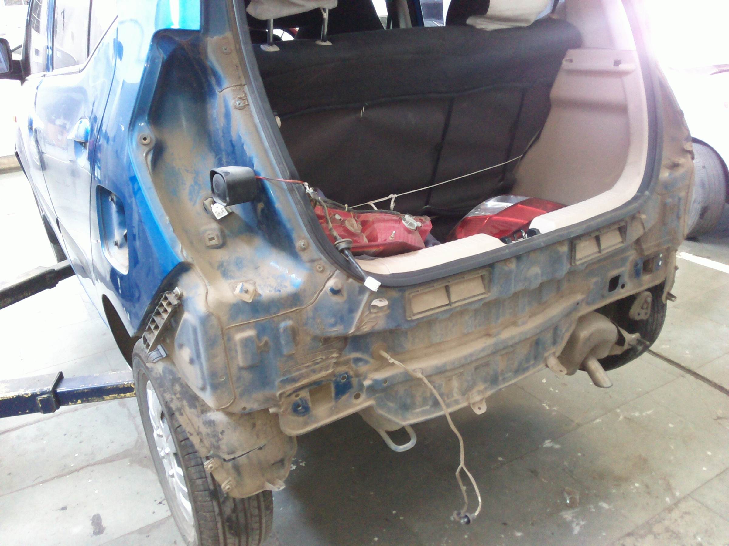

Odo 47k Kms.
The blue boy is serving well. Its truly zero maintainance car.

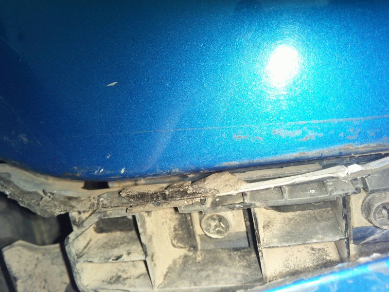

Unfortunately, A biker tore off rear bumper when dad was reversing the car out. Have placed the order for same at ASC. Stripes will also have to be redone on that area.

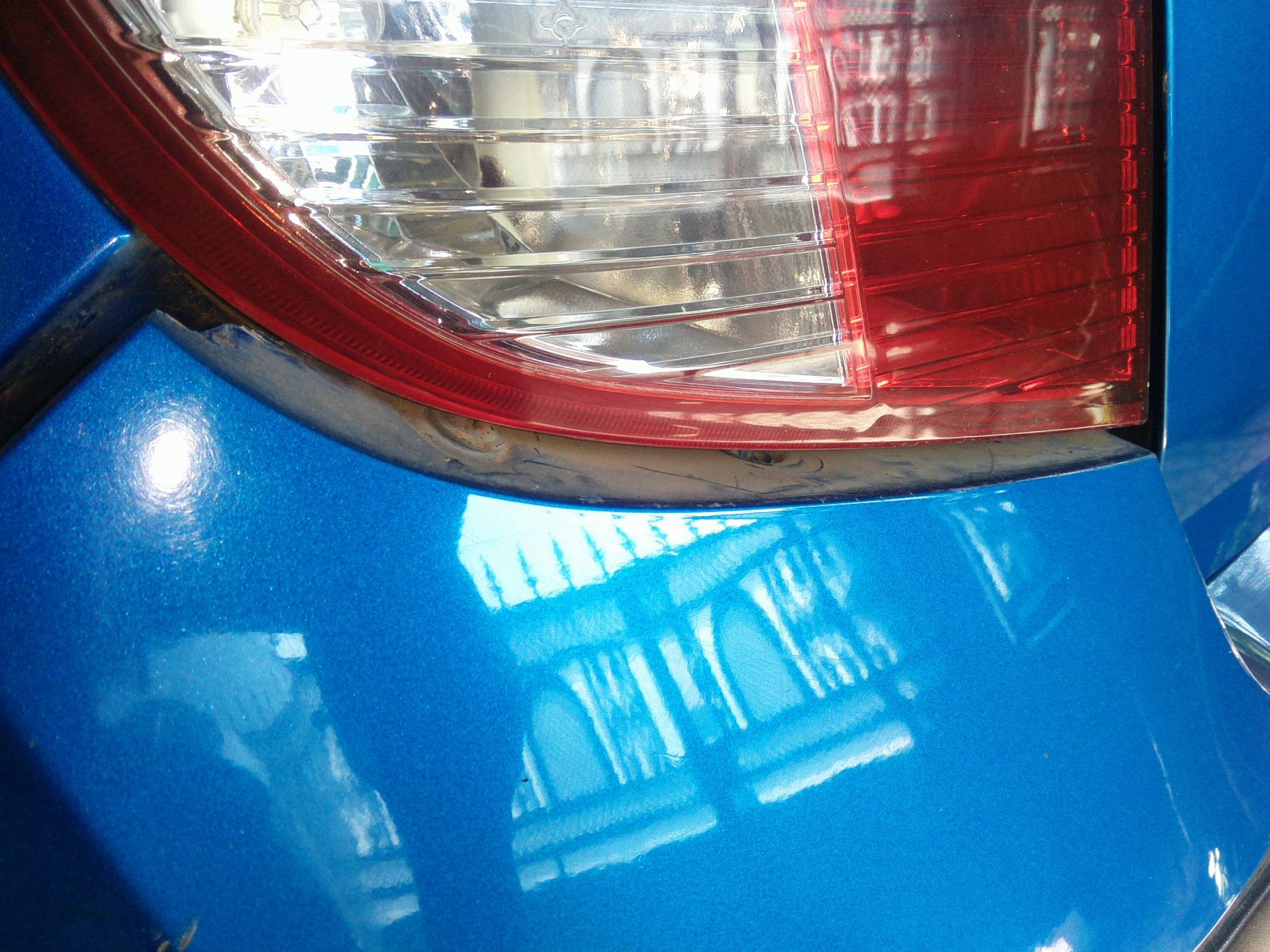

Went to the dealership for shade matching.
The color code on my Blue Boy is DE. But thats not all, there are 5 variants in DE with imperciptable difference between all. The painter choose one and Im all good with it. Still gave the fuel cap for proper shade matching to ensure accuracy.
BTW, mine was the only true BLUE boy in the entire dealership.

Posting update about new rear bumper.
