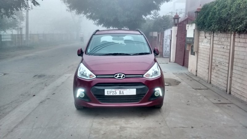

Hi Anuj
The drls sure look good and you got a good deal from ebay as well. I have fixed the same kind of drls on my car as well and I have also connected the white wire to the parking light which dims the drls to 50% when the parking light is turned on. My mechanic also connected one wire to the fuse box however the drls turn off immediately when i turn off the ignition. There is no delay whatsoever. I would suggest you take the car back to your mechanic and have him check it.
Hey Jonathan, tried all the fuses, turns out in Asta the current runs for another minute after switching off the car, that might be the reason it is switching off promptly in your car and not in mine.
Rest assured it looks fantastic as come-home Leds [clap]. I hope it doesnt create additional load on battery.
It was a foggy morning yesterday in Lucknow, clicked few more pics in all combinations, DRLs are pretty bright for the kind of day light we are having here during winters.
