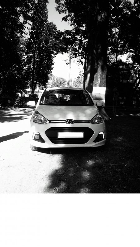

Guys got the DRLs fitted to the car
DRLs bought from Ebay for Rs 4500
DRLs connected to ignition. I didnt connect the third wire which will Dim the DRLs when HL are switched on
Light up nearby area very well.
Also fitted ring shaped LEDs, connected with parking, pretty bright
I have ran into one issue though, the mechanic connected the DRL wire to Fusebox as given in the pic, In our car even after the ignition is off, current flow through that fuse and after 90 secs DRLs switch off (Mistakenly they are like a come home light now). Friends please suggest some other wiring mechanism to correct this.

Hi Anuj
The drls sure look good and you got a good deal from ebay as well. I have fixed the same kind of drls on my car as well and I have also connected the white wire to the parking light which dims the drls to 50% when the parking light is turned on. My mechanic also connected one wire to the fuse box however the drls turn off immediately when i turn off the ignition. There is no delay whatsoever. I would suggest you take the car back to your mechanic and have him check it.
