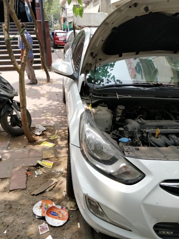

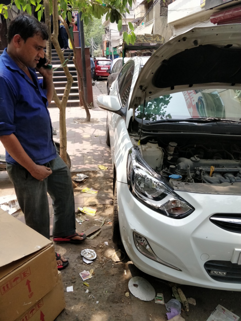

Got original new headlights for the car today, 5400rs for a pair.
Gobbled up the entire boot space.
You have to unscrew three bolts to remove the headlights. One bolt is clearly visible when you open the hood. You have to remove the upper portion of the bumper to access the rest of the two bolts.
Comparison between the old and the new ones.
