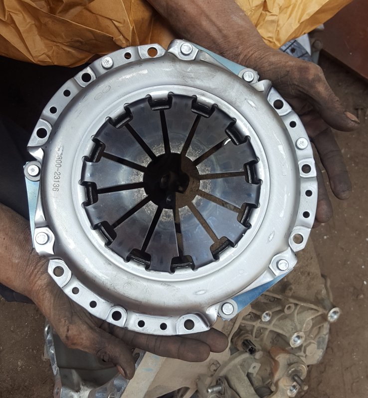

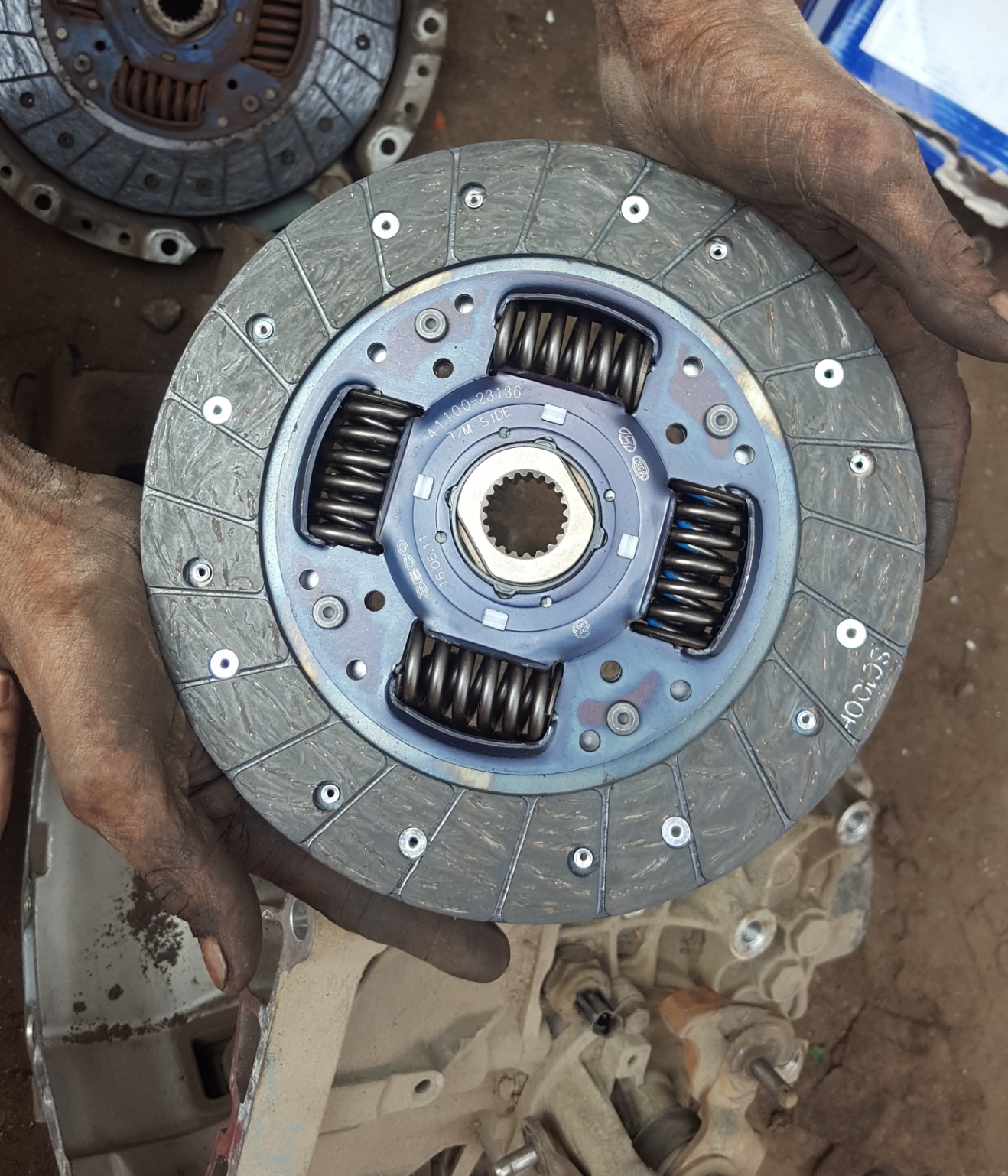

Some pics that i clicked today. Clutch brand used by hyundai SEKO.

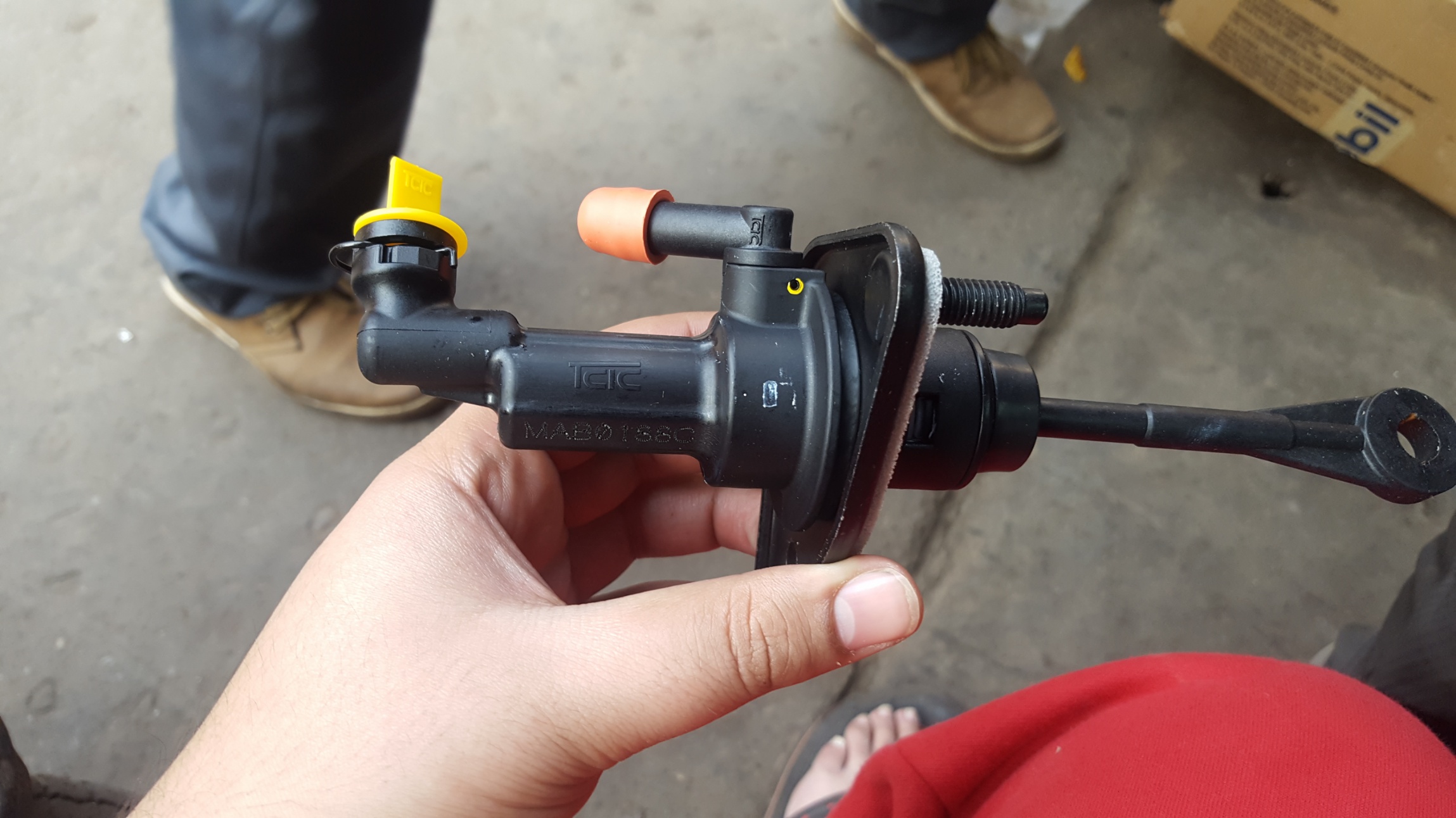

The master cylider was working fine but the mechanic screwed up big time. Air got in the system , he tried to bleed but the part didn't circulate any brake fluid.
Shocked after checking the price at 4500rs for a new one.

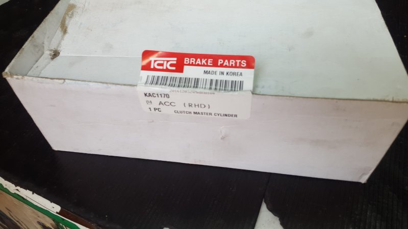

Went to the local shop and he showed me some indian made cylinder for 1150rs.
Went to the second shop and i had a smile on my face after looking at the OEM symbol on thr packaging and even a bigger smile after listening the price of 900rs. Double checked the original part and bought it.
Same thing happened with brake pads also. Parts in hyundai packaging are sometimes 4-5 times the cost of OE suppliers. Still i am not sure if the part will survive or not just because of the price difference. The part is such if it fails , i will be left stranded.
Clutch make was SEKO. Will definitely ask for OE packaging rather than hyundai.
Original part
OE part. Surprised that i was able to buy this from a local shop.
