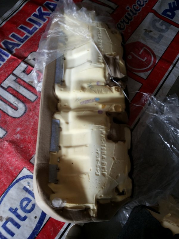

I found the Mayur seat cover material during my search. Ordered from Local Car Decor shop. Now the pics.
Seats were Dismantled.

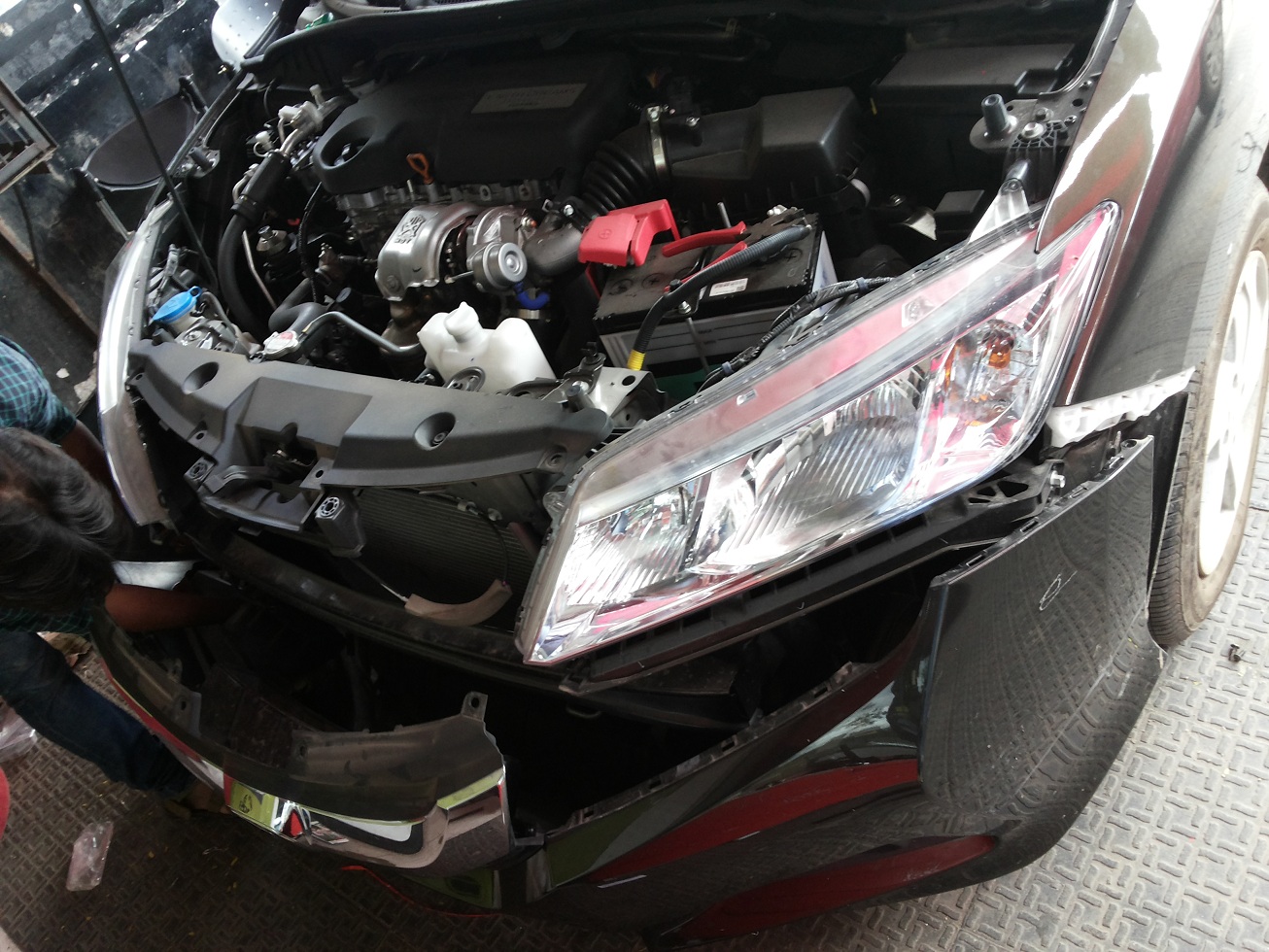

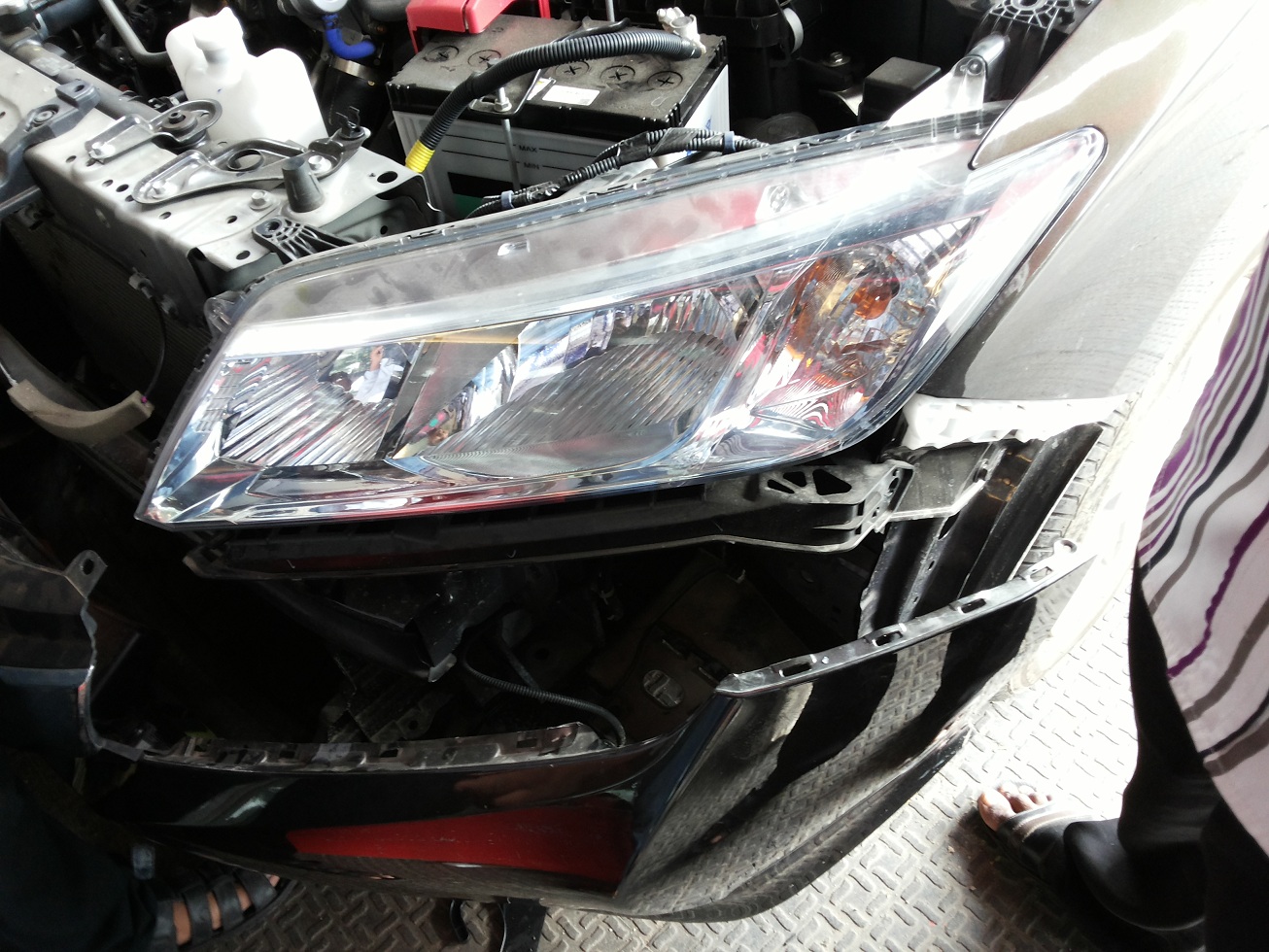

Lamp wiring was disconnected
Wiring disconnection is going on the driver side.

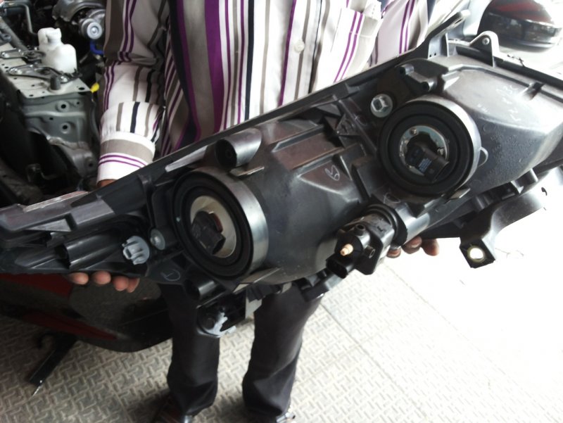

Back side of the Head light assembly

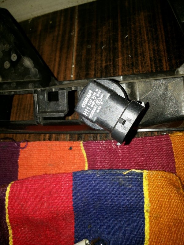

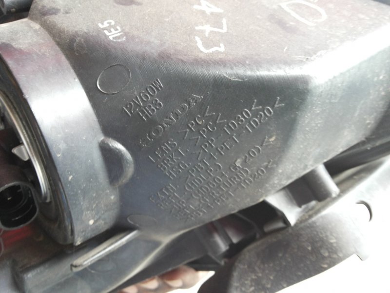

H11 Stock lamp in my City.

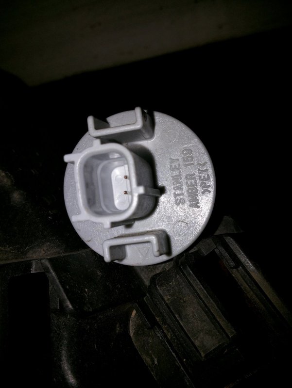

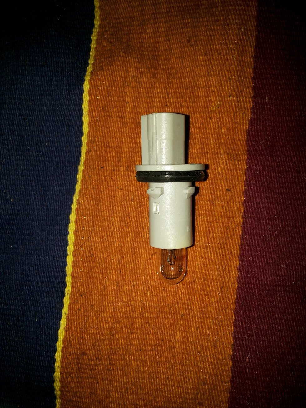

Parking and indication lamp by Stanley

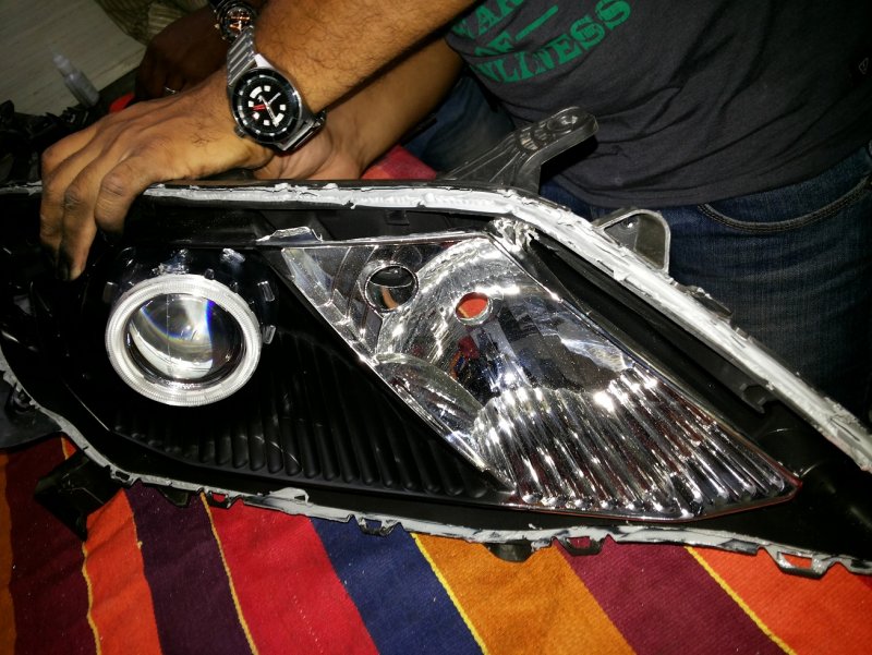

Heating of Headlight to melt the sealing.

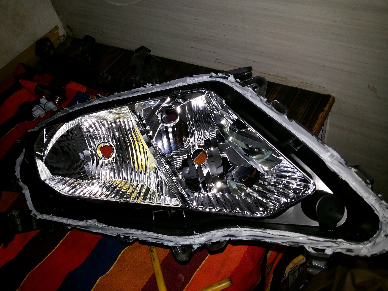

Headlight opening is in progress.
Opened reflector assembly

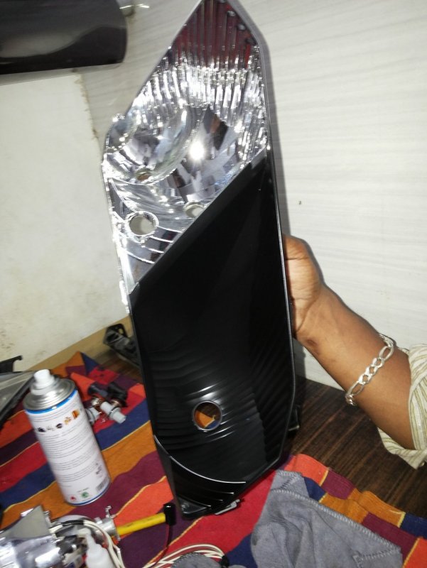

Glass & grill assembly

Masked Low beam reflector area.
Projector Lamp
Now angel eye on the head light
Re-fixing of Eye in Eye replacement surgery.
With new better and beautiful eyes. Angel Ashtra got angel eyes.

Some Questions
1.As stock setup has different lights for High and Low beam, how bi-xenon works?
Now it is connected in only Low Beam, as High Beam can't accommodate the projector head light. So Only Low beam works. Currently I have stock high beam lamps, after changing no requirement of high beam for me.
Some Questions
2.How Stock high beam light connected after installation i.e will it illuminate if how?
Stock High beam will function as normal. But you will get yellow light with stock lamps. Projector gives 5000K white & yellow mixture light
Some Questions
3.Is there any cut on the reflector?
Yes, cutout was made in the back side of the reflector to accommodate the projector headlight. Nothing in the front. I have masked the low bear reflector.

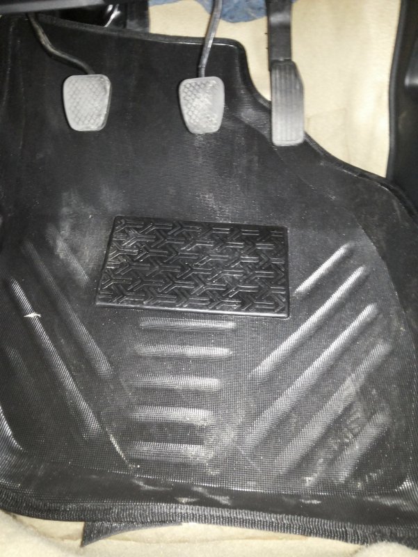

The Floor mats
Based on TAI members feedback, I got Digifit 3D floor mats for Ashtra from Snapdeal. But for a Honda City, I selected for a black one.
Driver Side
Co-Driver side
Rear Seat.
The fit & furnish is fine.
This mat is available in two colour. one is Black, and another one is Beige (TAN)
