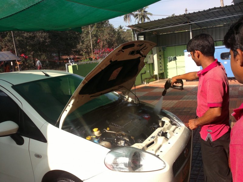

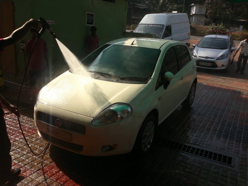

Wow! It is wonderful to see the beauty getting a shower [;)]
Those are exceptional FE's! Till date the most I have got is 19, but may be because I just can not stop myself from pushing her a little!
Do we have any such automated car washes in Pune?

I really envy your beast buddy. I have been trying to search for some good body wash outlet but couldnt find any here in Ranchi.
Even I am surprised in a small town like mine we have such good facilities.
Rs 200 for washing/waxing and Rs.100 for interior vaccum.
You deserve for taking so good care of your 90HP!
Owning her for one year was a pleasant experience so the caring happened naturally.She serves like an all rounder; FE,Performance comfort and Luxury.
