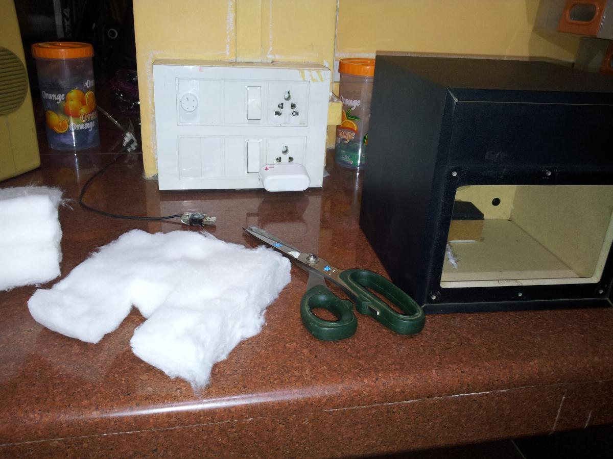

Next Step is to add Poly fill inside the enclosure. Idea is that this fluffy stuff slows the waves and makes the box appear as larger. This helps with deeper bass extension.
There is no rule of thumb. Try an Inch thick layer on the bottom for a start. Then add A piece of cotton gauze on top as this is a ported enclosure. Otherwise the Fibres could eject out from the port. I did not require glue as the part of circuit board held the Fiber nicely in place, but you may want to glue it down.

But all is not Done!. The amount of Poly fill can be varied to "Tune" the bass response to your liking. So take your time to fine tune it. Here are are some Improvements/Changes I noticed before and after the mod-
1. Boomy Bass has gone down. The bass notes are now a nice THUMP rather than a woof or doof. I am utterly pleased to have the tight, Hard hitting bass compared to loose flabbing and Boomy bass of earlier.
2. Peaky resonances have cut off.
3. The subwoofer has a more low, Growling tone. The sub also mixes well with the soundstage. Locating the sub by ear is now more difficult. Lower octaves are now more pronounced and distortion free.
4. Deeper notes do no cause the driver to bottom out as easily
5. Any vocals coming from the woofer are absent!
6. The Woofer level control is now useable till 3/4th rather than 1/2 as earlier. The woofer does not flab around uncontrollably at 3/4 compared to before.
7. About 10% of volume has reduced. Something that can be easily set using EQ or Woofer level dial.
8. The woofer is now more enjoyable for a wider level of music Generes. Classical, Instrumentals which used to sound crappy earlier are now more pleasant.
