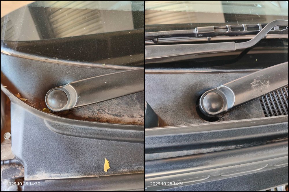

Using a flat head screwdriver, remove the caps covering the wiper arm nuts
Two caps were removed using the flat head attachment from the Taparia 1/4" socket set
Nuts holding the wiper arm in place
Removed the two nuts using the 14mm socket from Tata Agrico 1/2" socket set

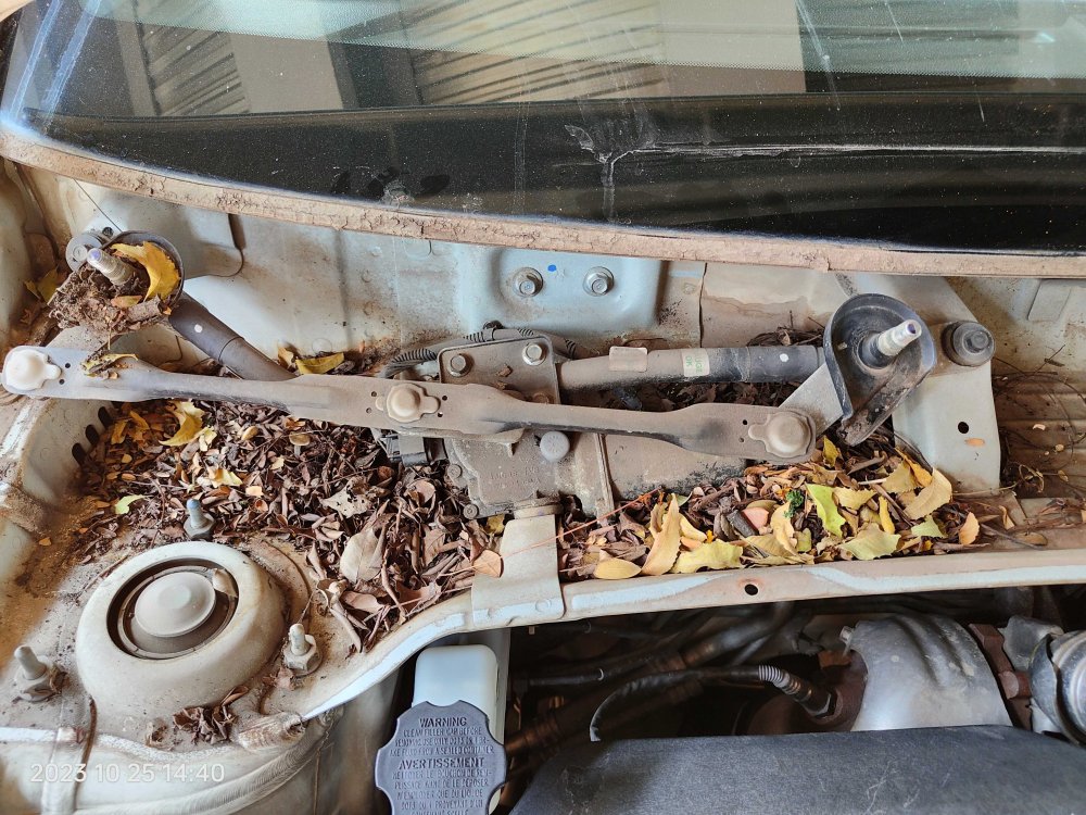

Press down on the wiper arm and remove them from the bolt holding them. Seeing this after removing the wiper arm, I knew there was a lot to clean
The Cowl panel was removed - The shock of my life. This is how much was accumulated in 4 years and 9 months. Damn!

Removed all the debris/leaves from the panel area
