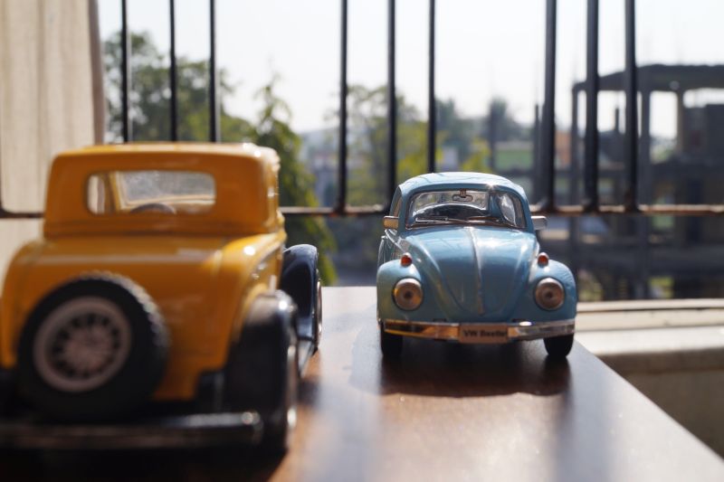

hello Everyone,
Sorry for the long wait of a month.Could not upload the pictures as because of final examinations.Here the pictures finally!
Products used-
1.Plywood- Front-Globe Marine Ply 12mm
Back-Ecotech 4mm ply
2.Laminate-Royal Touche East Indian rosewood
You can check it here-https://www.royaletouche.com/laminate/48jw/
3.Side covered with Teakwood beat
