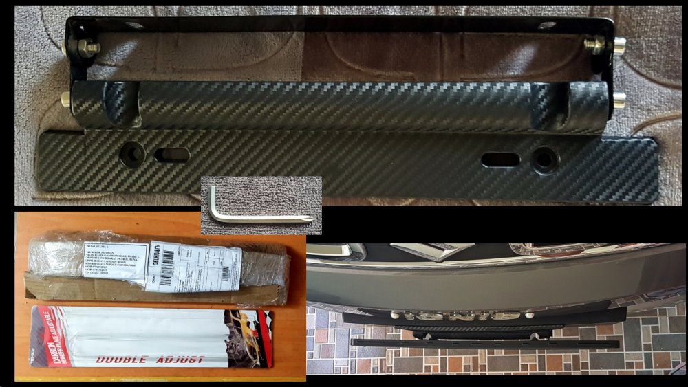

DIY - Added 3D License Plate Holder
I did to my car as I liked and felt it has aesthetic appeal.[;)]
After inspired by this VIDEO, I ordered one from Amazon. It appeared a low quality with rusted nuts and bolts, I returned it.
Ordered another one from this GETINSTALL and found as a better one, reasonly priced.
I didn't want it to project unnaturally, so kept it only little more, but it needed some support at the back, so used a bit of black EPE foam.
Pros:
Appeared different and unique.
Cons:
1. Allen Key bolts are difficult to secure, so replaced with good star type ones.
2. Needs proper fitting with back support as it gets tilted on external pressure.
Please Note: [think]
A. Your attention is required that it may be against Indian Road Traffic Rules. In fact, in India , adding aftermarket extra horns, lights, stickers, roof wrapping , front bumber gaurd, sun control films etc., and even the black plastic license plate holder provided at the Dealer's spot are all not as per norms.
B. HSRP ( High-Security Registration Plate) rules are yet to be implemented strictly in my area. Need to check how it's viewed by local authorities in our area/state; better to avoid if we often travel to other states.
