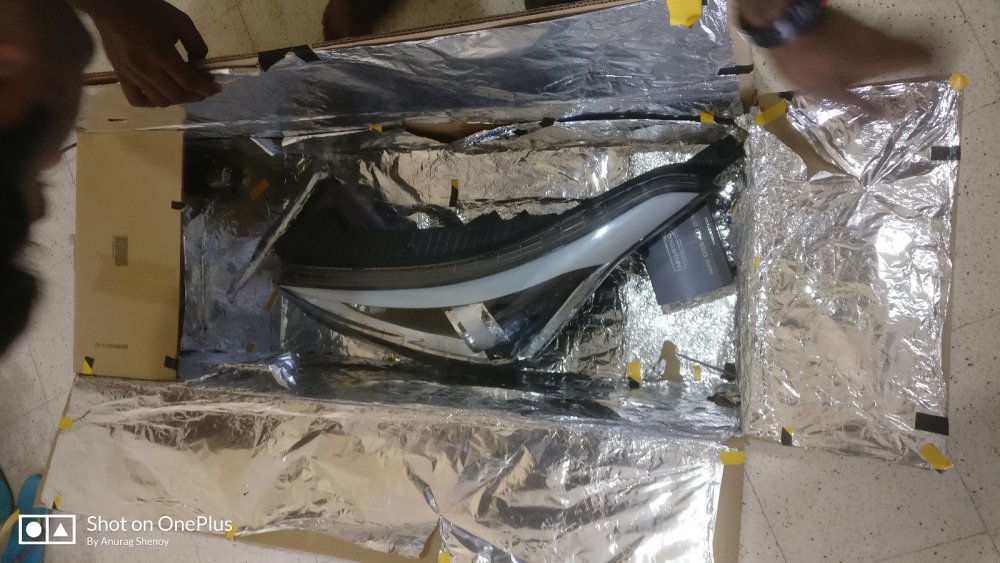

Home-made oven to open the headlights
Placed the headlight inside to heat it to soften the sealant
Used a hot-air blower to heat the box

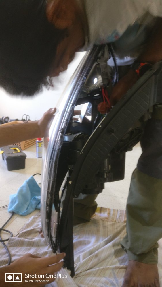

Manual heating to soften further to separate the clear lens from the headlight casing
Almost separated

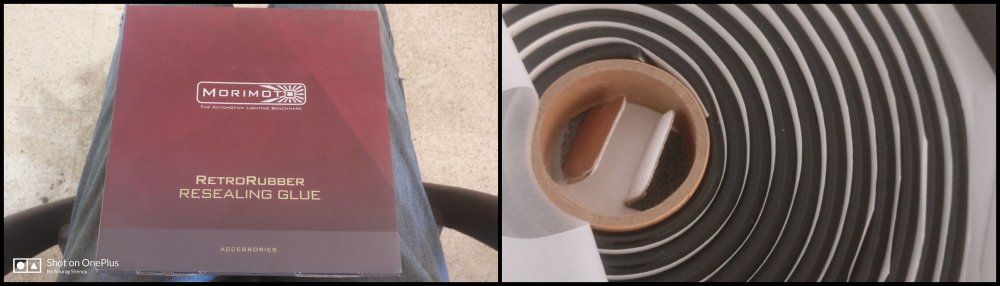

A fresh bead of butyl rubber added
After the butyl rubber bead was placed and the clear lens was pressed in place, these clips were used to hold and sandwich the clear lens and plastic body for a good and uniform seal
Morimoto Original butyl rubber used for the DIY

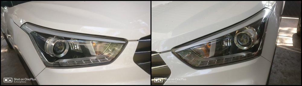

No condensation or water ingress
The DIY MOD was performed when the odometer was around 45,000 kms and the current odometer is 1.33L kms. Since then after multiple pressure washes and exposure to rain, I am happy that the headlights have been free of any condensation or water ingress during washes.

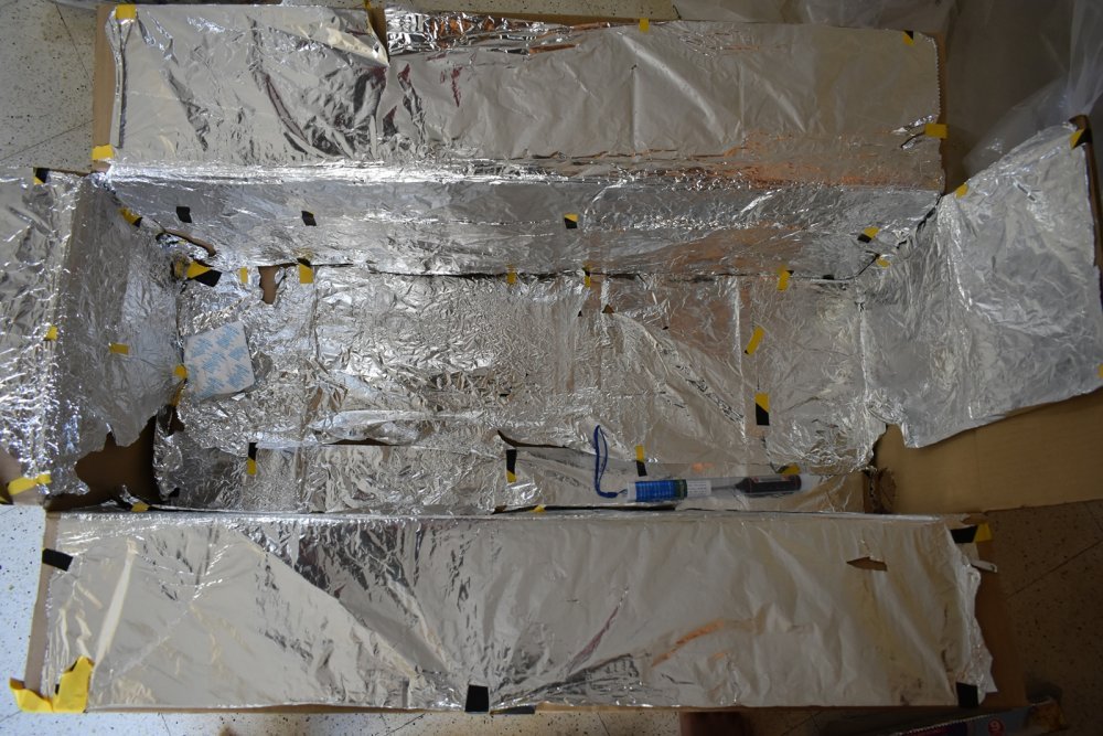

Dr MUDHAN, Do you recommend such home made design of Heat Box ?
Honestly, Yes & No!
YES :
If you know what you're doing!
Food grade Aluminum foil is very thin and weak, and it can't stop the heat from reaching the wrapped material, actually that helps here @ a vigilant and controlled environment when we monitor properly the process step by step / internal temperature.
Note: This works well on small/medium size headlights previously sealed with thermolabile sealants like Silicane, Butyl etc.,
Check this video:
NO :
1. If Permanent Sealant is used
to seal the OE headlight; we really need to work more to detach the sealing by using a professional oven. It is harder than soft butyl, we need to put the headlamp into the real, professional oven to heat several times... through pry, bake, pry, bake…repeat method.
2. Due to fire hazard involved! One should not take the risk if he doesn't know what he is trying to do.
Due to the risk existing between Cardboard Box and the Blower. The Blower nozzle gets very hot; the hot plate grill inside a heat gun gets red hot & Cardboard is a combustible material. Aluminum foil is not flammable but it can melt at very high temperatures.
Note: Heat can travel in three ways: by Radiation, Convection, and Conduction.
Normal Aluminum foil can reflect some of the radiant heat, but it can't block the transferring and conducted heat, which are the main sources of fire.
