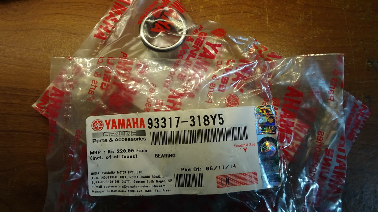

Swingarm Bush - 21CF218400 - ₹ 40.00 x 2
Swingarm Bearing - 93317318YS - ₹ 220.00 x 2
Used to cost only ₹69 a piece in 2012. Now almost 3 times costly.

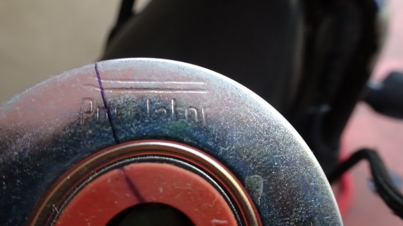

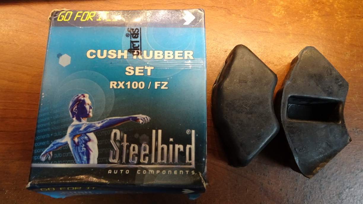

Steelbird Damper Clutch - ₹ 80.00
Genuine Yamaha was ₹ 40.00 in 2011 and ₹48.00 in 2013.

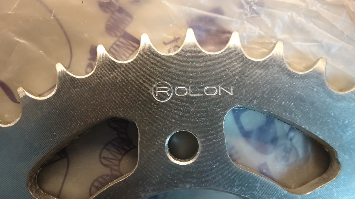

Rolon X Ring Chain Sprocket Kit - ₹ 1,265.00
Claims to have more life. Stock kit is Rolon O-Ring Kit.

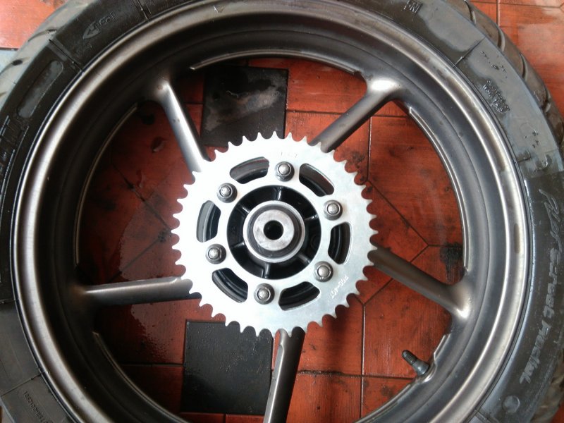

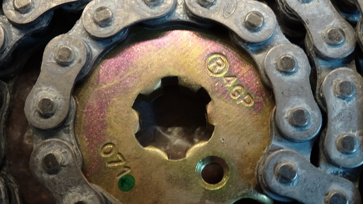

Rear sprocket looks same as stock plus the Rolon markings and specs.
Drive Sprocket comes in different finish than stock.

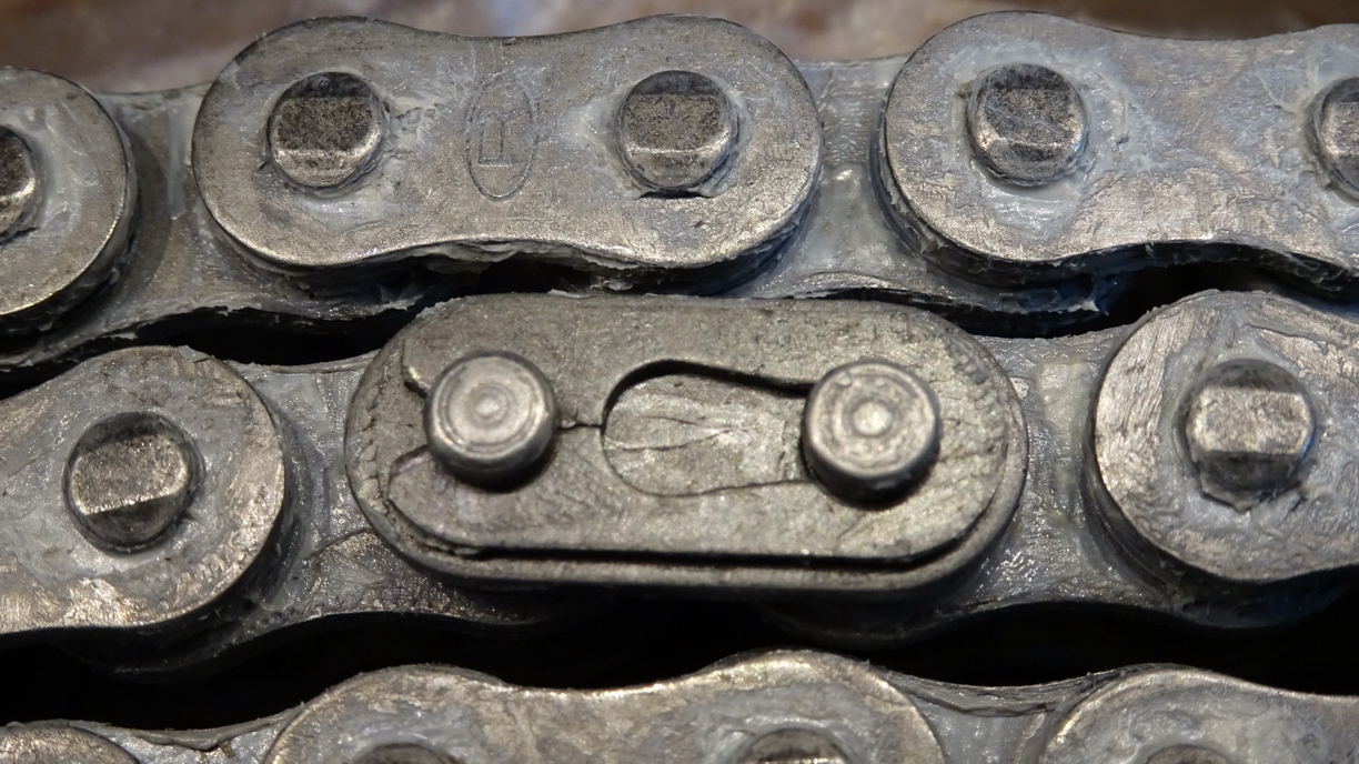

X-Ring chain got removable master link unlike the O-ring.
Difference between O and X is the just the rubber gasket in each chain link. It seals grease between each link. X-ring has an X shaped cross section and the depression can hold more lube, that's what they claim.

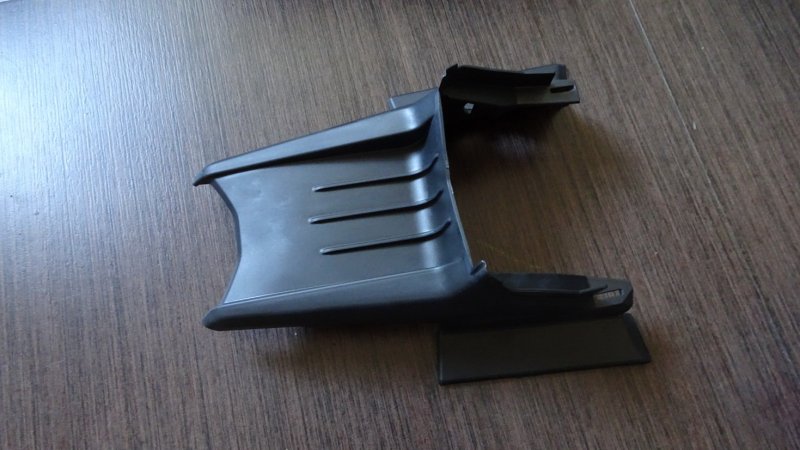

More parts. Mudflap/Fender Assembly Kit
21CWF16000 - ₹ 178.00
Wanted only this one. Cost was around 40 only, but had to buy full kit as the single piece was out of stock.
Original first extension type. Didn't use though.
Came with all sorts of required screws and template for drilling hole.

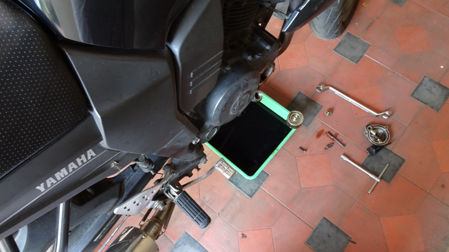

Oil Change. How 3.5k km old oil look like.
and 6k km old filter.

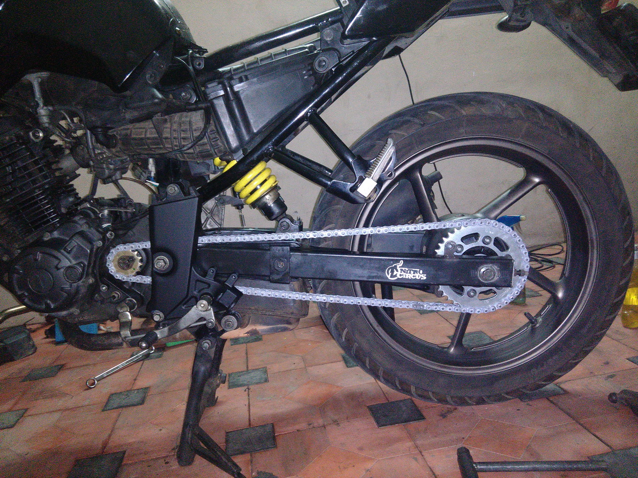

Major work Swingarm overhaul, chain-sprocket change, exhaust swap, fender swap, some painting, in-depth cleaning, etc. in single go.
Cleaned everything in diesel.
Stock exhaust back.

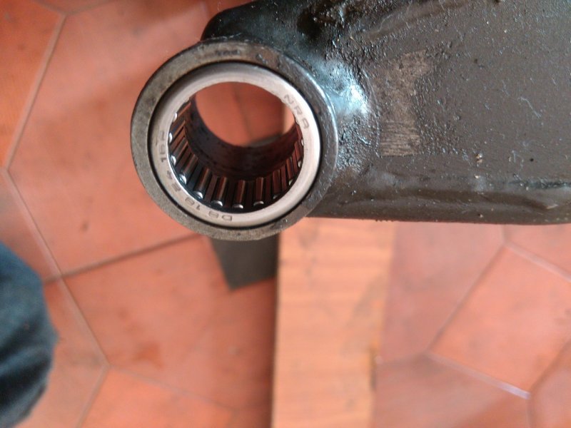

Knocked off old bearing.
New bearing in.
Swingarm bush. Old vs new.

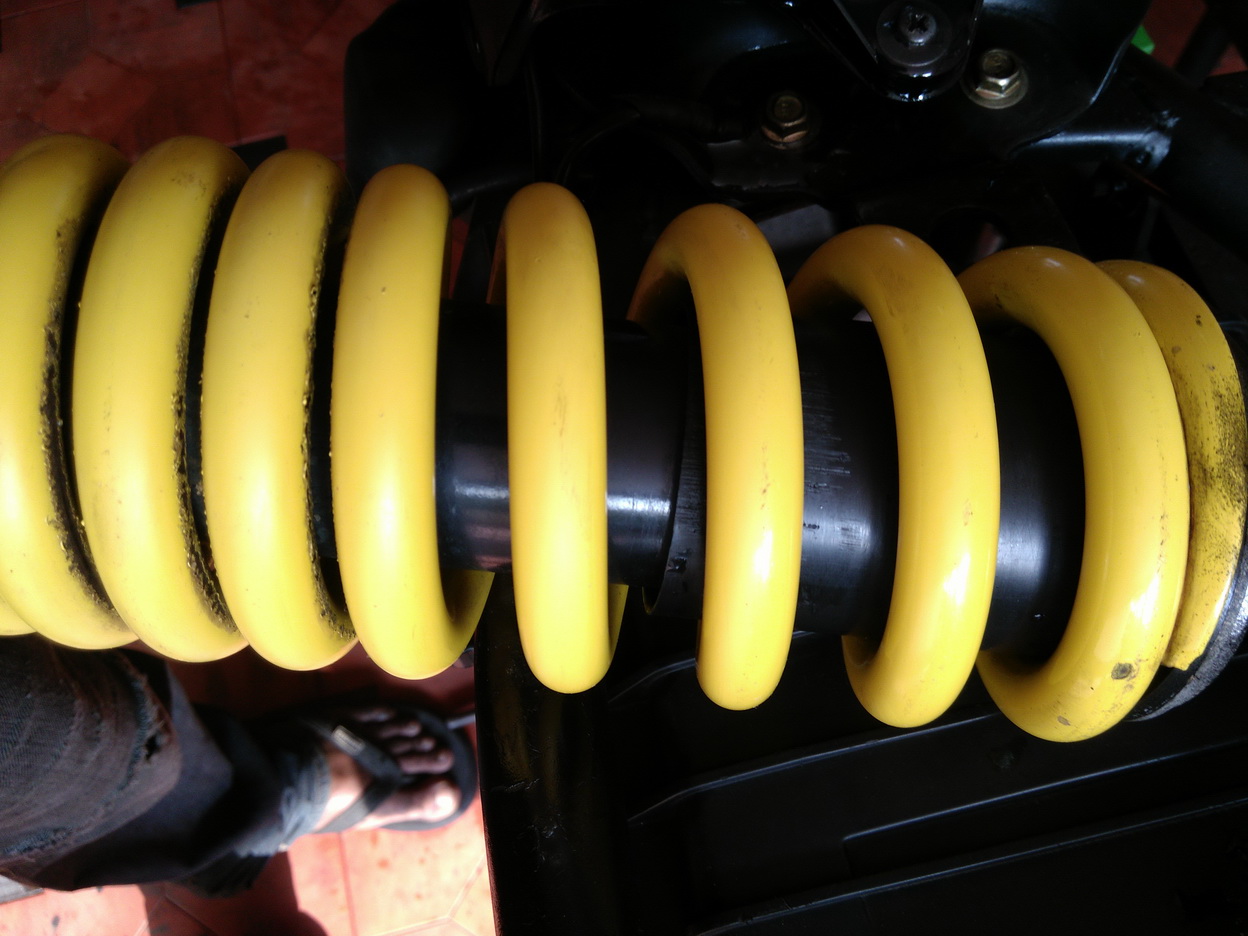

Monoshock. Cleaned. Spring rusted a bit, slight leak, but still works fine. Had a squeeky noise, but gone after adjusting tension.
Painted the footpeg set. Primered. Last time missed primering, resulting in premature peeling.
Matt black.
New sprocket
After install.

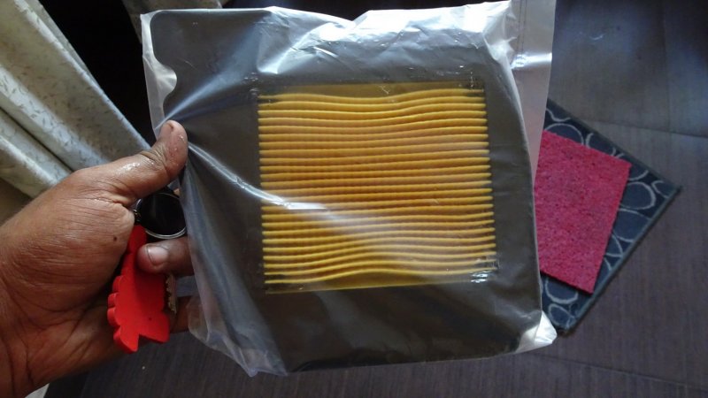

New airfilter. No carton cover, only polythene cover now.
21C-E4450-00 ₹ 215.00
Blowby oil in filter box.
Old vs new.
