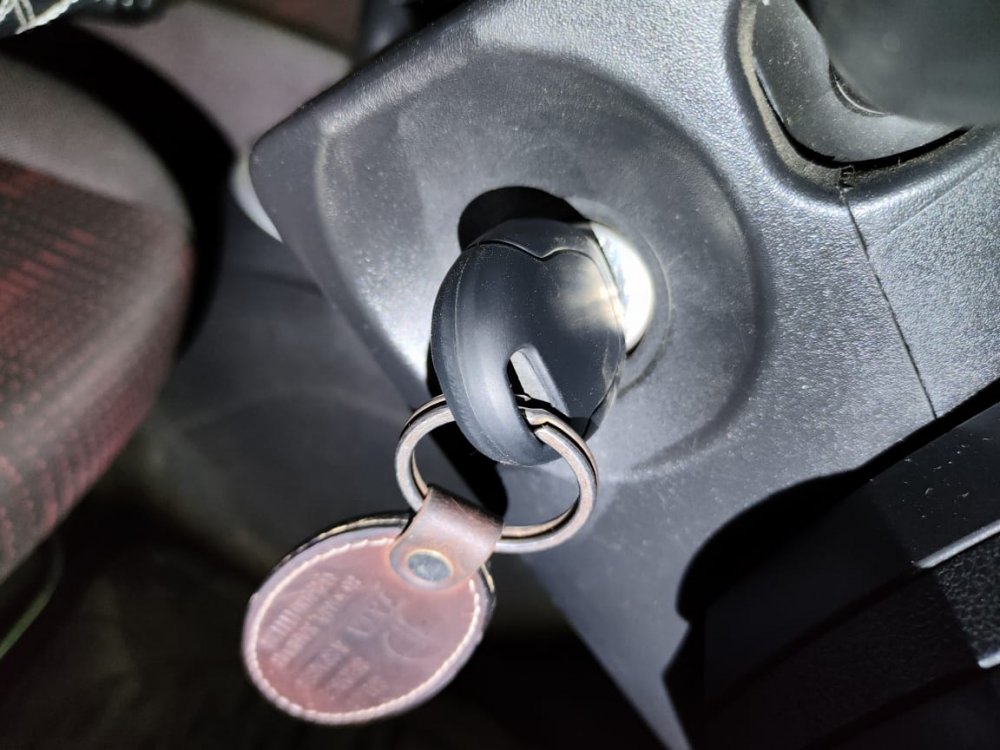

Useful and unique feature of my Figo petrol
After stalling the car on my home slope, I learned a unique thing about my Figo. Once a car stops /stalls at position I or II the key cannot be turned further to position III. It sort of gets locked !! Even if the car engine is running the key cannot move further, to protect accidental double crank on a running engine. You will have to move the key to 0 position again to restart.
This is a unique thing which Ford owners will be used to. For me its a new and useful feature. Its called crank protection. Or Starter protection. This is not seen in my swift ,Ritz, 800,of that era. I am very pleasantly surprised to find this on my Figo.
Markings are not obvious to naked eyes, pics make it clear

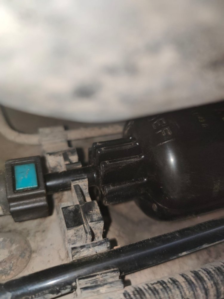

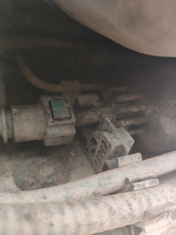

DIY changing Figo petrol filter.
I decided to change it myself since Ford ASS wanted the car for a day, yes believe it, for a whole day, just for the damn filter. Fine ! I will do it myself.
It is not easily accessible like in my swift, where it was in the engine bay near the firewall. Here it lies behind the rear left tyre, below the left rear passenger door. So jack and jack stands are required. It cannot be accessed just by bending under the car as there is not enough space.
Old filter is slightly tricky to access. Remove the fuel lines first.
covered in 11 years of mud and grime.
Push this button to loosen the filter
In and Out flow direction sign on the old filter. Look how dirty its from the outside
How much dirt will be on the inside??
SOGEFI brand filter
Thread Starter #130
mayankdixit
May 16, 2014
1,891
3,371
kanpur
Continued.
New filter
Genuine Ford part
SOGEFI branded
Plastic clips can break if handled roughly
All set. Switch on the car to check.
Blue is the input side of petrol lock button. Push to remove/put back new part
yellow is the output side lock button
Mount the filter keeping in mind the direction of petrol flow.

Car has uneven idle.
Now this problem is solved. Looks like this fuel filter was very dirty and maybe clogged as well. Fuel was sitting inside it without much movement for 1 full year, during covid times.
Now that I think of it , I do realise that I should have changed the filter earlier. Postponed due to unusual position of the part, under the body.
Spares availability was an issue too.
ASS as usual was totally non- helpfull. Wanted me to leave the car for 1full day. It took me half an hour.
