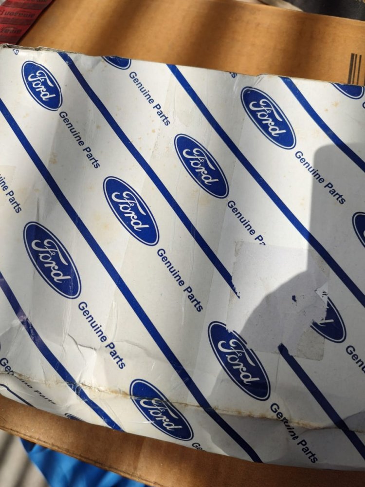

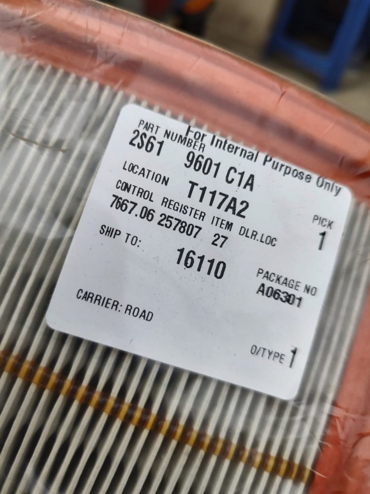

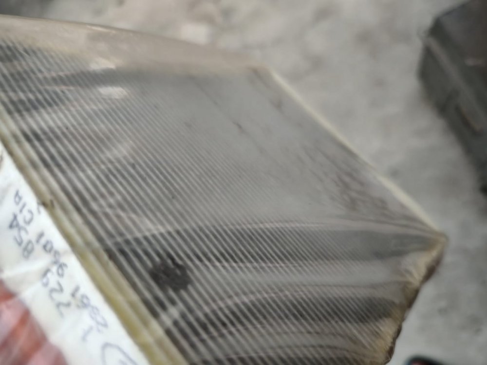

Ford Figo petrol New engine air filter.
I was surprised to see the old filter was not dirty as expected. It's more than a decade old and yet it can be used further if cleaned properly.
I was in a dilemma, whether to keep using the old filter or put in the new one right away. But better sense prevailed and I have put the new one in the car.
Pictures of original packaging
New and old
part no. and price
New and old side by side

It's cheaper than the after-market parts even after being imported. ZIP filter was around 250. Betrayal garage charged 650 for after-market (Opel) filter.

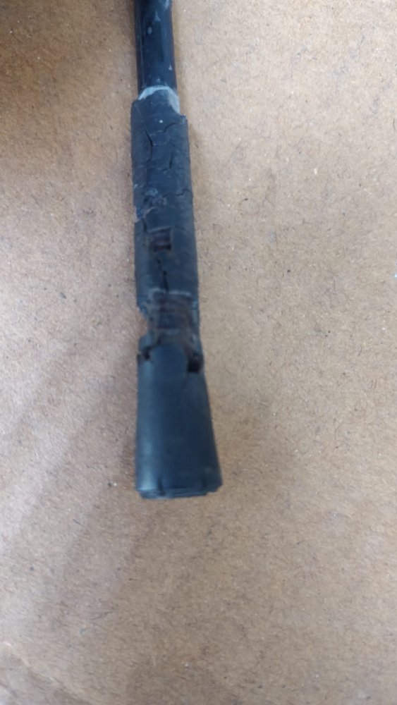

Radio antenna of Figo has taken quite a beating for a decade in the open sun. Although the receiver / FM transmission works fine ,the look of the antenna has gone for a toss. Rubber and plastic is peeling off.
I searched for the replacement all over, but its very costly in the accessories store. I have decided to either replace it with OEM antenna, or go for a shorter version as seen in Maruti cars.

Almost all Ford antennas I have seen are peeled over time. @vishnu vichu and @bikerharis replaced them with new on their Fiestas. I just covered it with heat shrink sleeve. Sad part is most of the aftermarket antennas won't fit directly. There are two type of bases, male and female. If it's female, then universal ones will fit. I think it is M4 or M5 thread size. It the base is male, then only Ford OE will fit. Stock antenna for male base costs 800-900 and female one is cheaper like 400-500.

This is the present condition of the antenna. Comparison of the new with the old
Rubber part is disintegrating

plastc,and rubber is falling off just by touching
