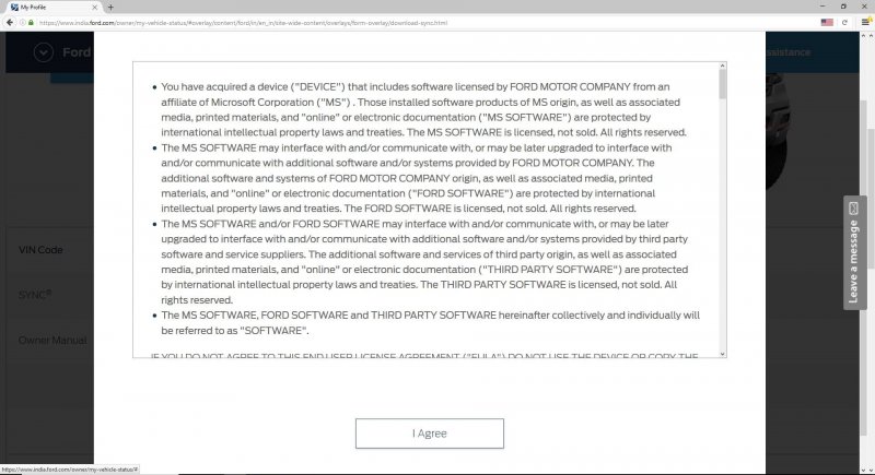

Step 2: Click on Update New Version which would open a new pop-up window.
Step 3: Clicking on Request Download will take you to a user agreement which if you agree would start the process of generating a customized VIN specific download package and it’s link would be shared with-in 24 hours.
Step 4: Depending on the load on the server, the email with directions to return to update page with embedded link in the text SYNC Software Update would be received. In my case, the email was received in a couple of minutes. Clicking on the link embedded text would take you to the pop-up with info on downloading the package where clicking on OK and then Start Download would start the download. The last pop-up also lists to have a FAT32 formatted 8GB or more pen drive ready. The package itself could be a large file and might take time in download. In my case, the package size was 3.2 GB. Soon after the download starts, an email would be received to report successful installation of SYNC Software update. More on this later.
