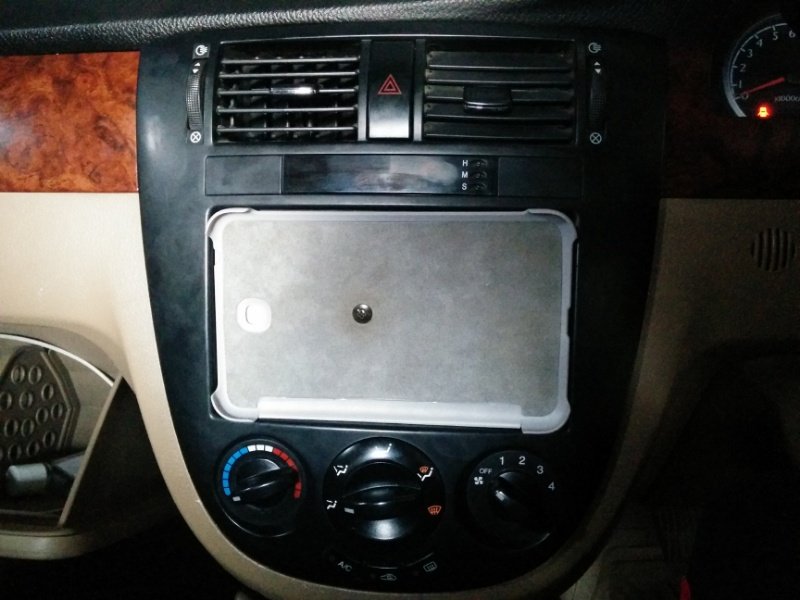

Things you need are a decent Tab 7 -8 inch with GPS and Maps installed , AUX cable, Tab flip or back cover made of hard plastic . A steel, aluminum or copper stripe . Screw driver, drill etc.

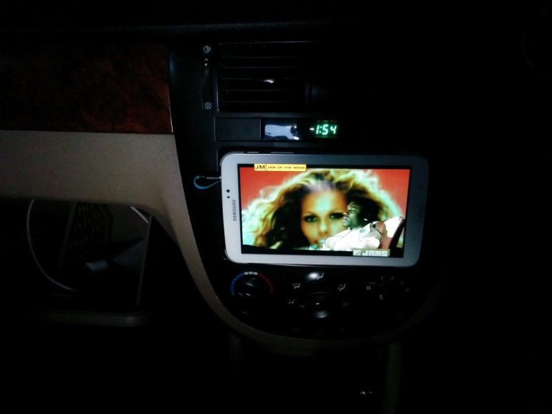

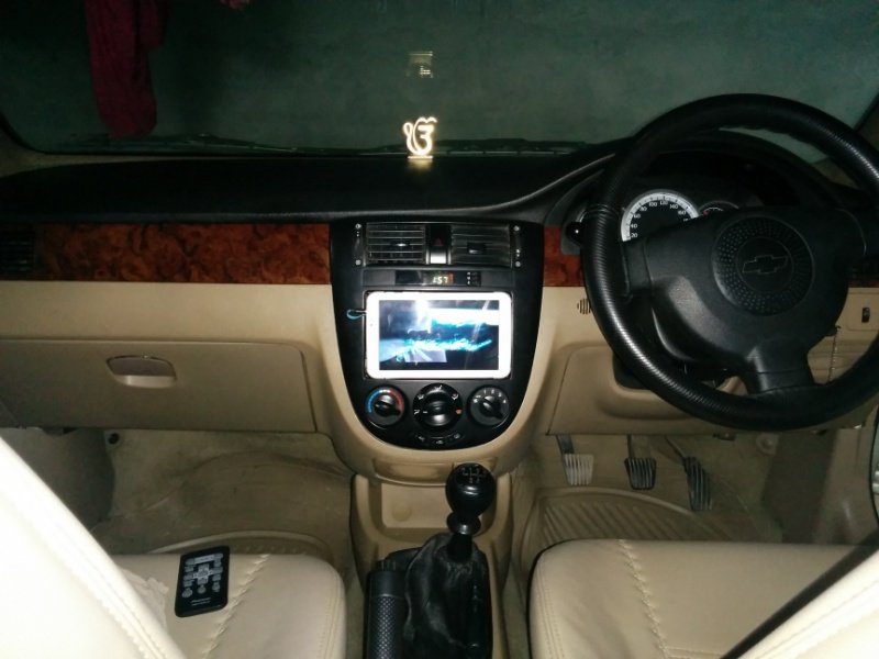

First of all you need to remove your head unit console. Take the measurement to drill holes in stripe and fix it in given headunit mounting point, if necessary adjust your head unit to up or down in the slots. Fix the stripe. Drill hole in your tablet cover. Now temporarily place the console back and take the measurement to drill the hole on stipe to attach tablet back cover. Drill the hole . Fix the back cover with a screw to the stripe.put an AUX cable in your head unit and adjust the volume and other settings to play media through tablet. Set the volume higher on head unit. Now fix the console back on its place carefully. Mount your tablet into its cover, attach aux cable. Done.
Enjoy music ,videos, free navigation , internet in your car on high resolution touch screen . Believe me your 25-30k headunit will never compete your 8-10k tablet in resolution , speed, and touch response. I am using Samsung Galaxy Tab 3 with 8 gb+ 32 gb memory for movies, songs. You can watch live TV also connecting tab with your mobile WiFi hotspot .
