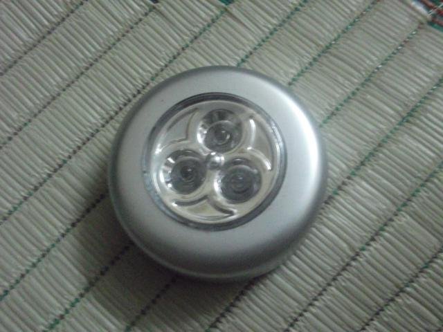

In my search I found this 3 LED touch light. I thought it would be correct for my kind of DIYians[:D] Pls go thru this post for more info about it

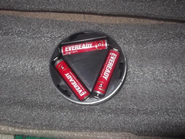

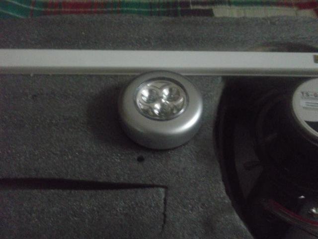

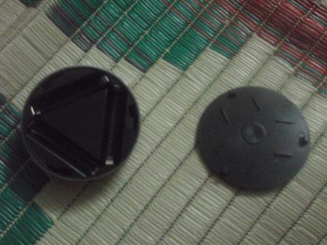

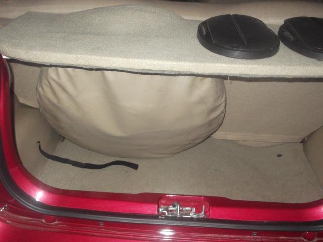

It has two parts. Top and bottom. Bottom they had provided self adhesive stickers [Which did not used]. I removed the bottom part [Kind of cover]. Drilled a hole in it along with parcel trey. Fixed it with a simple screw [First i tried with a screw which has bigger head so i was not able to fix the top part into the fixed one. So again I took another screw which has flat head and used it to fix].
After fixing that part, put 3 AAA batteries in the top unit and fixed that to bottom part which is already fixed in parcel trey [Just put and twist]

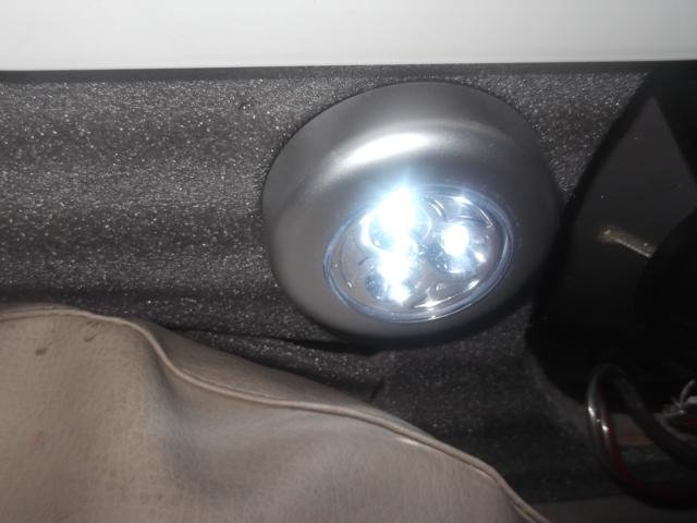

Perfect. The work is done and it is perfectly working. some times even after pressing it wont work [Either on or off]. I think it require some practice to press on right direction and position.

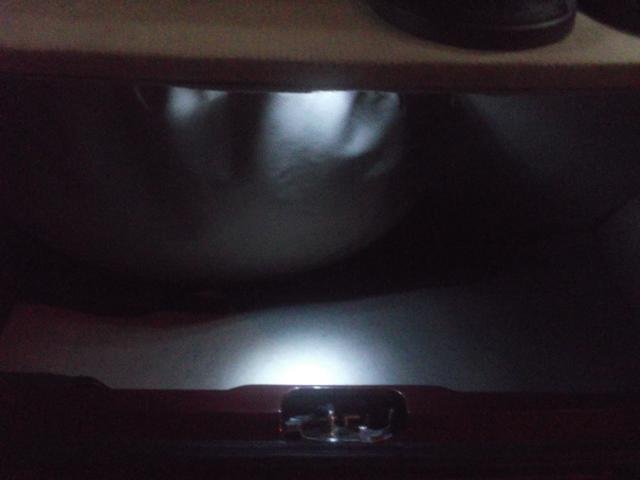

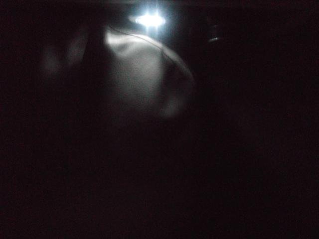

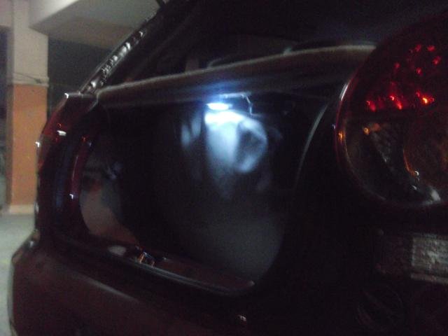

Once everything is done fixed the parcel trey in sparky. Wow it works nicely.
Only problem I have is, it is light is not spread and it is focused but no problem. It has enough light/brightness for that small boot space.

Some pictures I clicked during the process and finished job.

Sethu,
How will you replace the batteries? Do you have to Unscrew the light?

Sethu,
Arun pls see the last pic in the four illustrations in the above pic. Just twist the light it is removed. You can fix the batteries easily.

Super Cool ! Sethu , Do we get the same product with warm light (yellowish light)
For focus issued you can thoroughly sand the glass it will give a better output
Aug 18, 2011
486
40
The LED which you have put is a color which is bluish in appearance you can say it is (pure white). LED's also come in a warm white color (Ivory White)
Some pics to better explain
2nd Point - since you said that the light was more focussed i was saying that you should rub the glass of the light with fine sand paper so that the distribution of the light is even

Regarding color, I dont think other colors might be available. More over I did not got it from shop. I got it on ebay. If I would have got it in shop I may enquire for you and give details.
Regarding sand paper thing let me try if possible.
