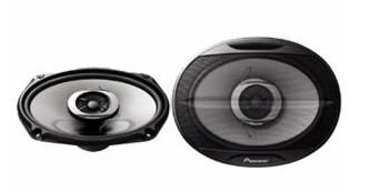

I have two speakers in front and two speakers in rear. Do not have much idea about the front but the back is pioneer 250W oval speakers.
Product features
  • IMPP Cone Woofer
  • PEI (Poly-Ether Imide) Balanced Dome Tweeter with Neodymium Magnet and Magnetic Fluid
  • Polyimide Voice Coil Bobbin
Specification:
  • Size 6"X 9" (163 X 237 mm), CONE
  • Max. Music Power (Nominal) 250W (35W)
  • Frequency Response 62-2400 Hz
  • Sensitivity (1 W/1 m) 90dB
  • Impedance 4 OHM
  • Mounting Depth 69.3(mm)
  • Cut-Out Dimensions 153 X 222 (mm)
The problem is always sound of the front speakers is more than rear speakers. Some times I feel that the rear speakers is not exists. Now a days always I try FAD option to keep the rear in high than the front. Then it seems to be okie.
